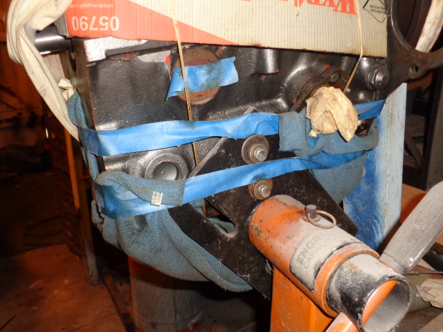

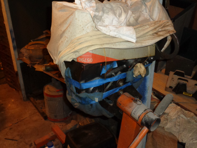

Hi Mike, Not sure about a 948. never had a engine stand back then, but a 1275 sits on one in the shop atm and it bolts up to the rear generator mounting holes..
HTH
