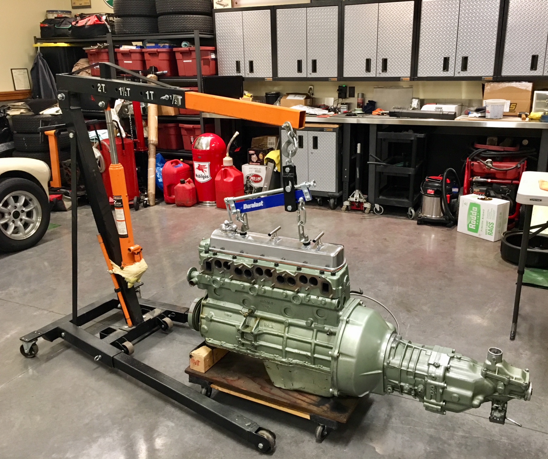

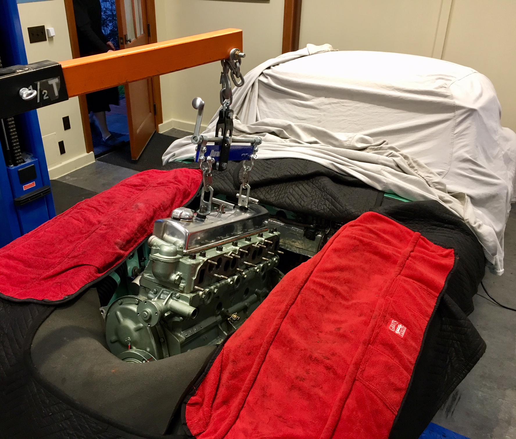

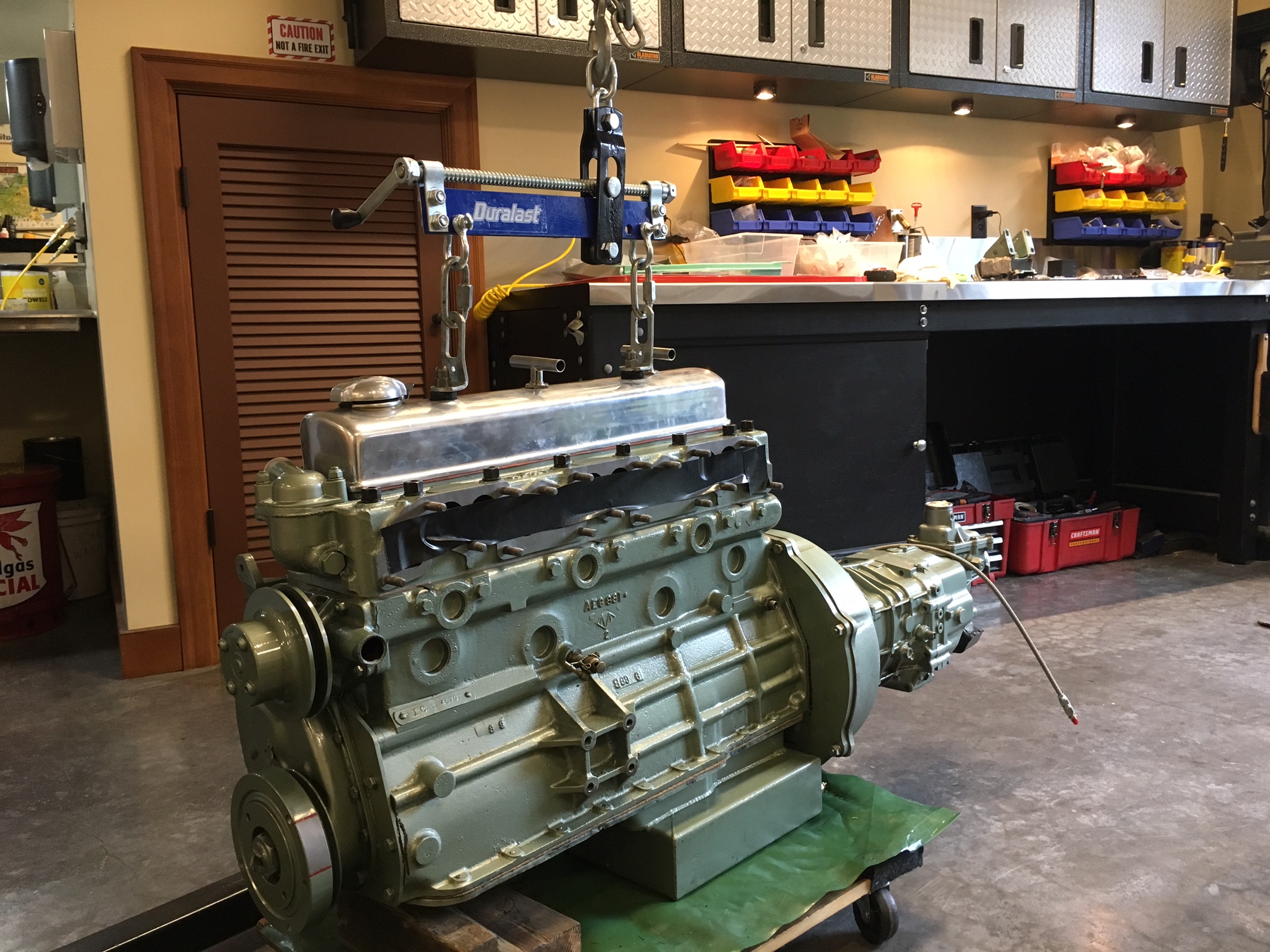

Multiple R&R's of my race engine over the last 15 years. Always done with trans in place.
