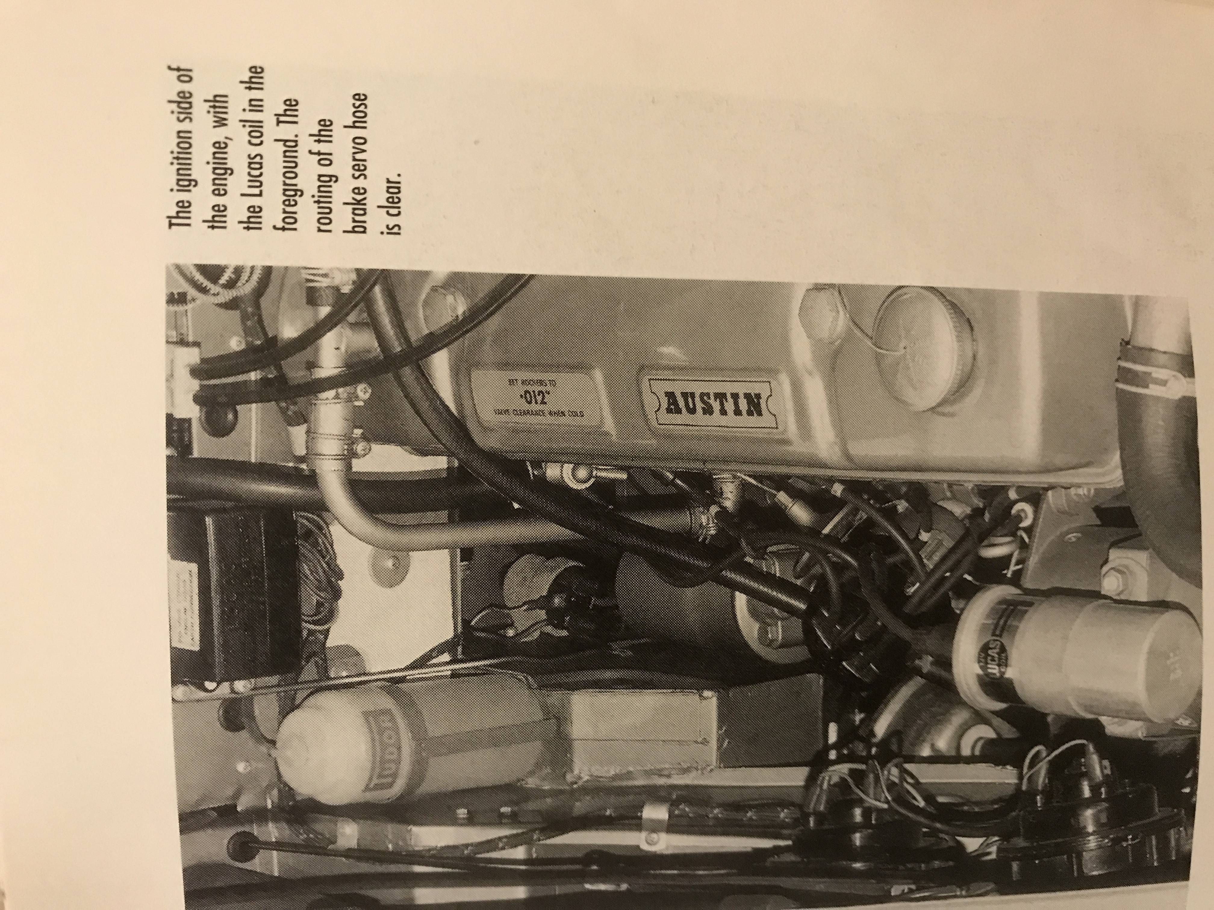

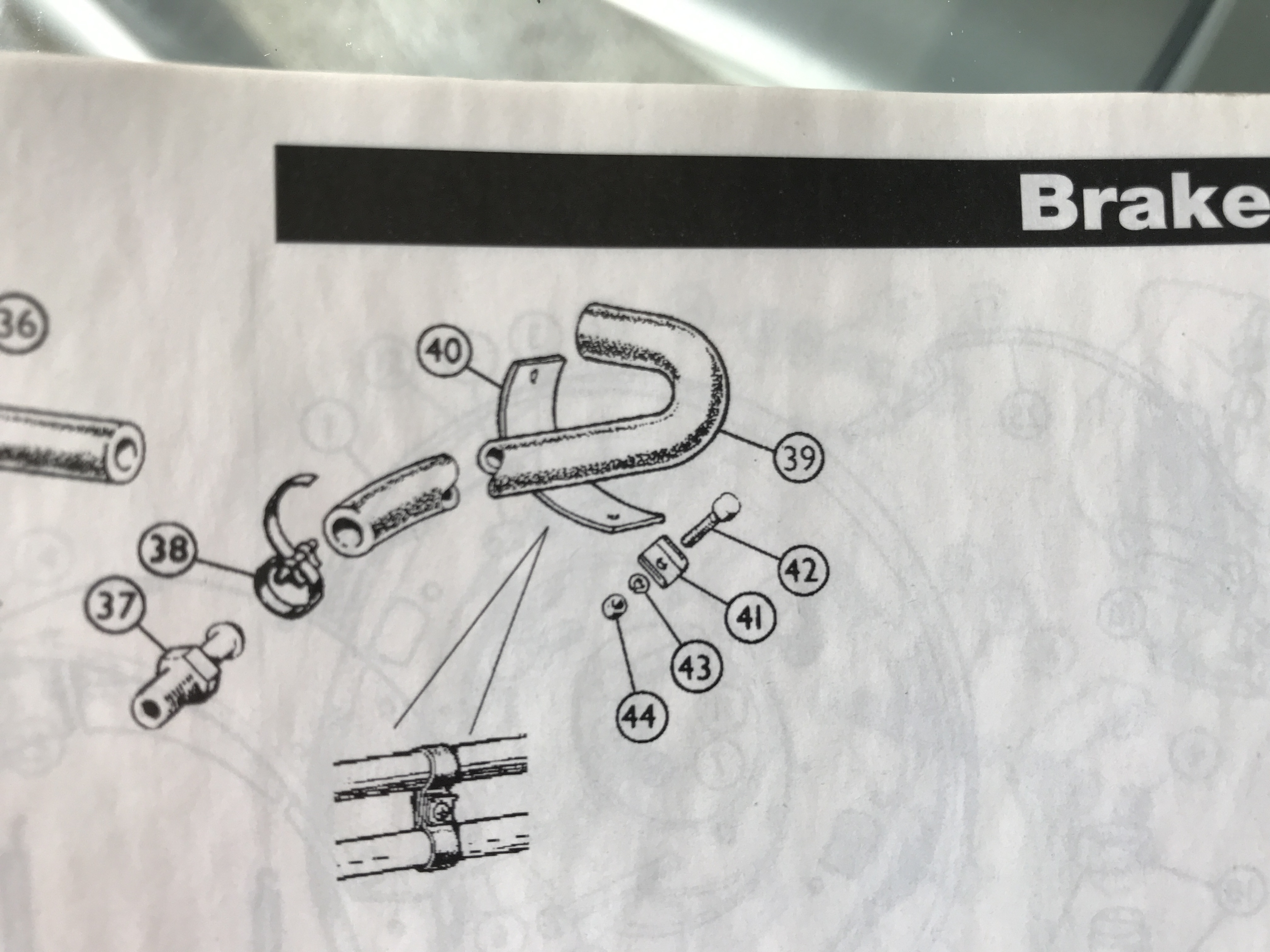

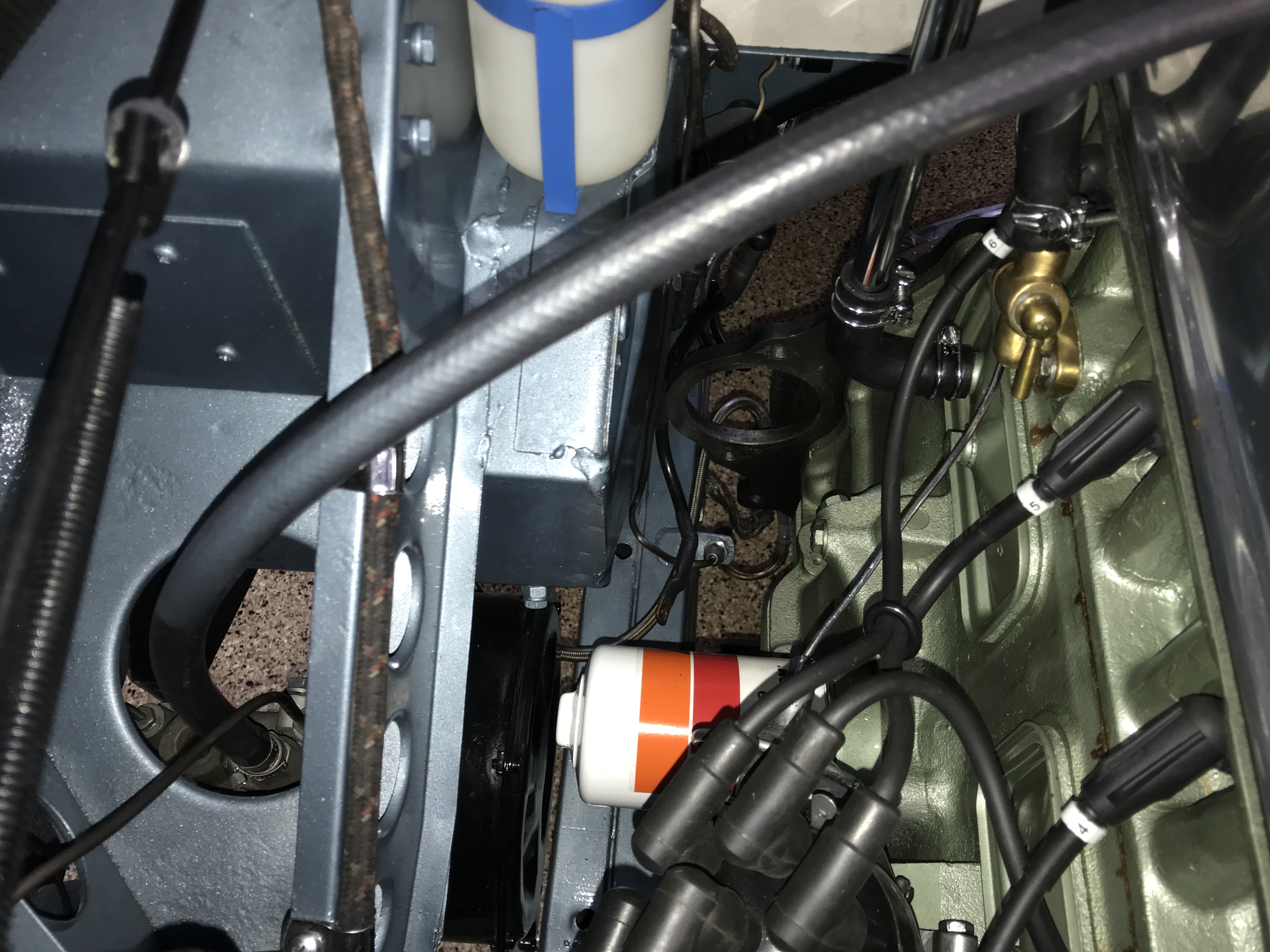

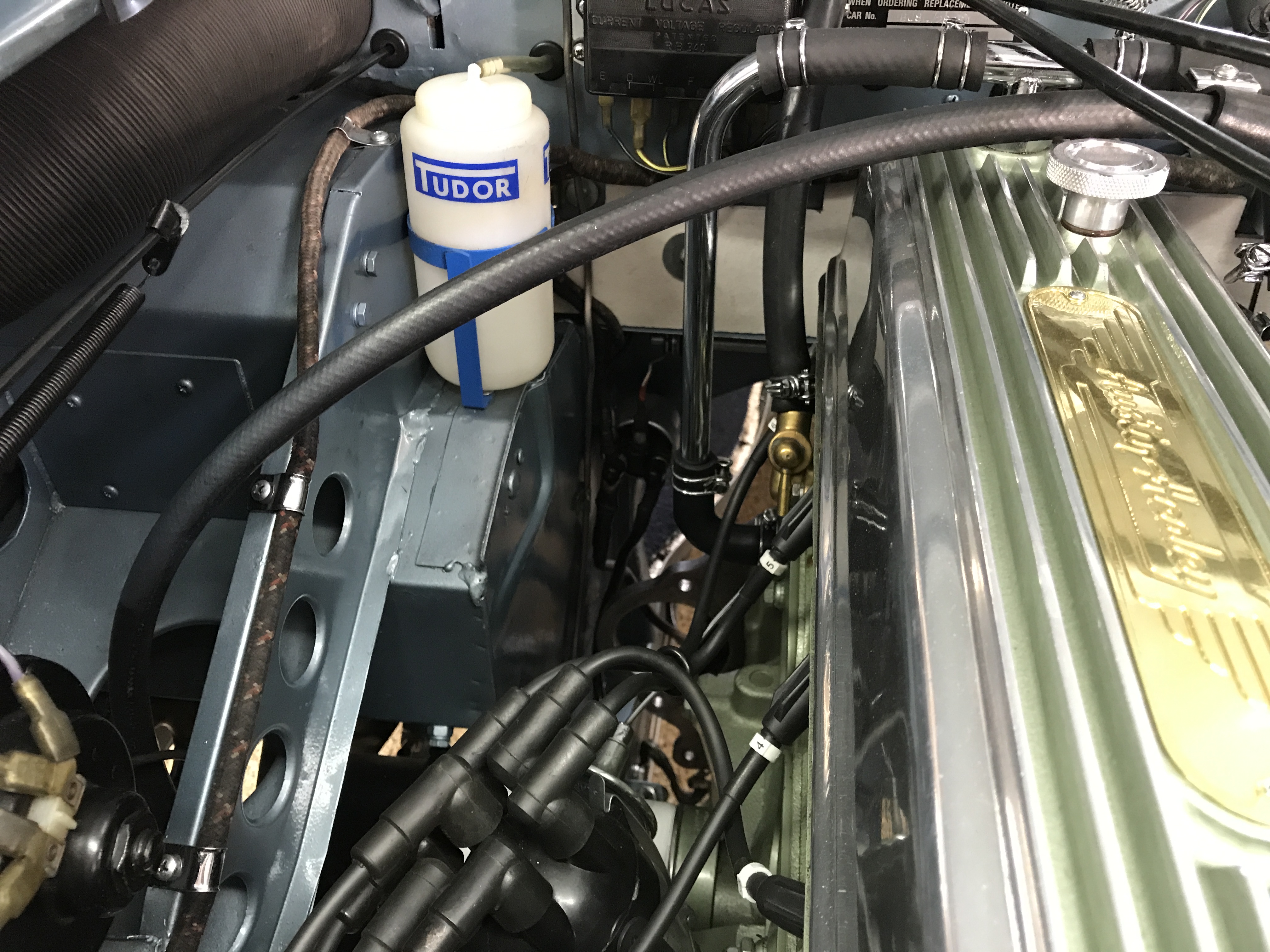

What's the correct routing for the break booster hose?
Was the break booster the same for the BJ7 as the BJ8?
Was there a design change during the BJ8 period?
Is my booster correct or an aftermarket design change?
My booster seems to be inward of the scuttle support brace compared to the booster in Anderson/Moment's guide. (That section covers BJ7/BJ8. It's not clear which model the photo's are referencing. I'll assume it's the BJ8)
My hose is straight, attaches straight down. The AM seems to be curved and exits the side.
I looked up the hose in Moss, the end seems to be moulded curved.
The curved hose makes sense for the booster that exits out the side and I guess I could put the curved hose on mine but it appears our boosters are different? Another part that's not factory correct nor routed correctly?... stop the madness.

AUSMHLY
LAW75, good luck with your concours event.
Here's what I see needs to be addressed (I've numbered them for further discussion) to be concours correct:

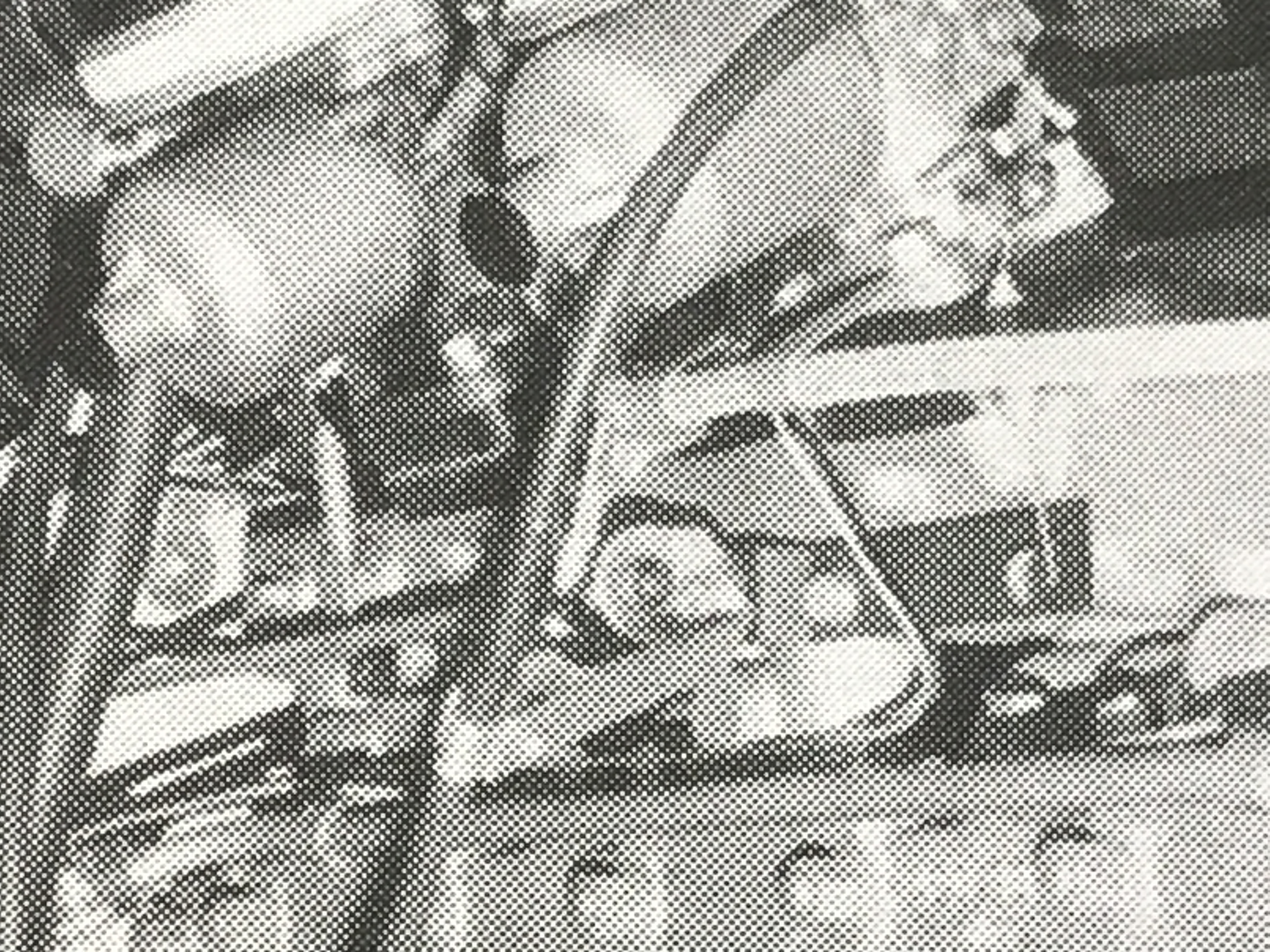

19) Vacuum pipe, is it bent correctly, shouldn't it be held in place with clips and should it be copper, steel or painted?
From the Moment/Anderson, text page 156, photo page 153

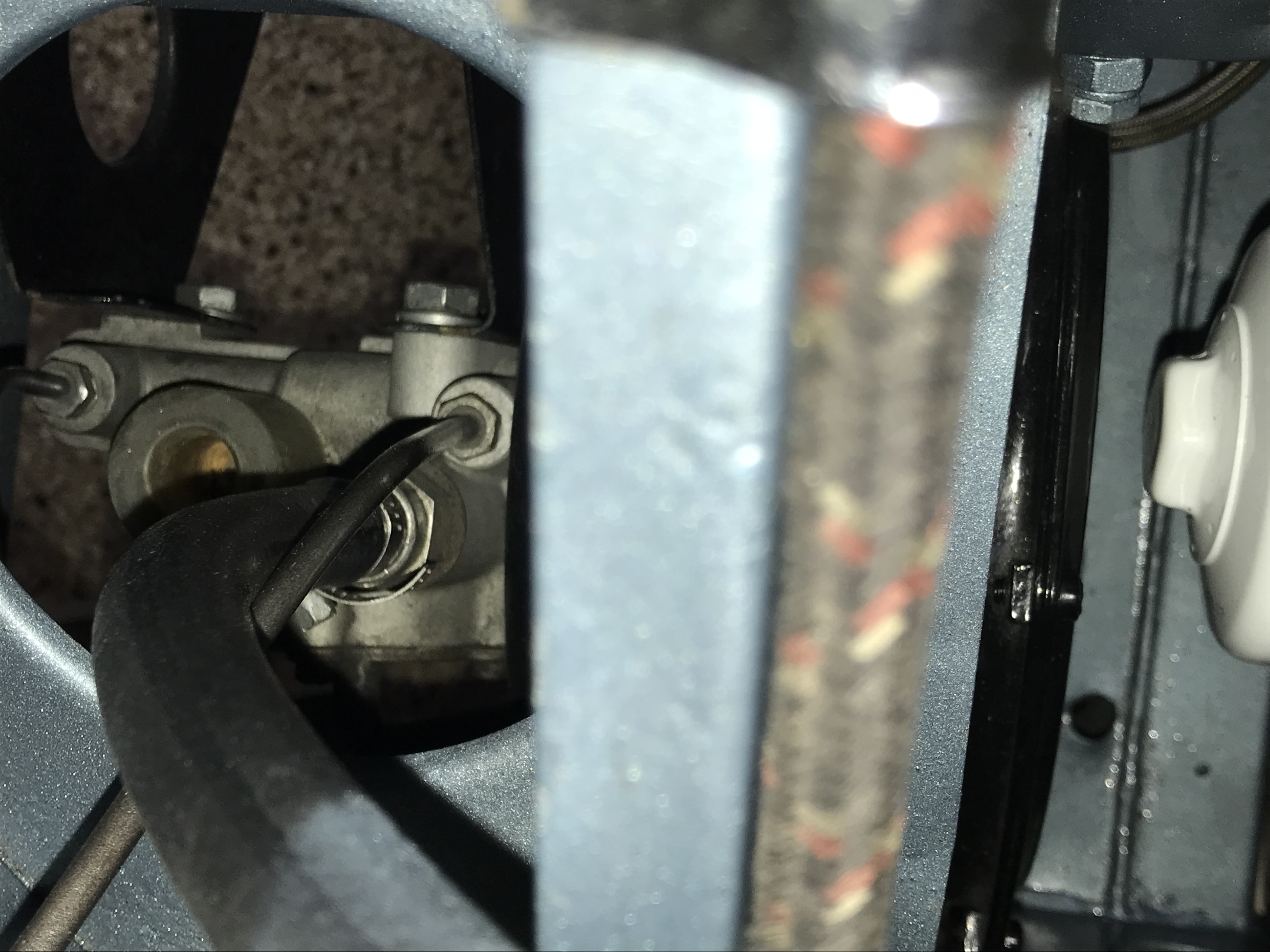

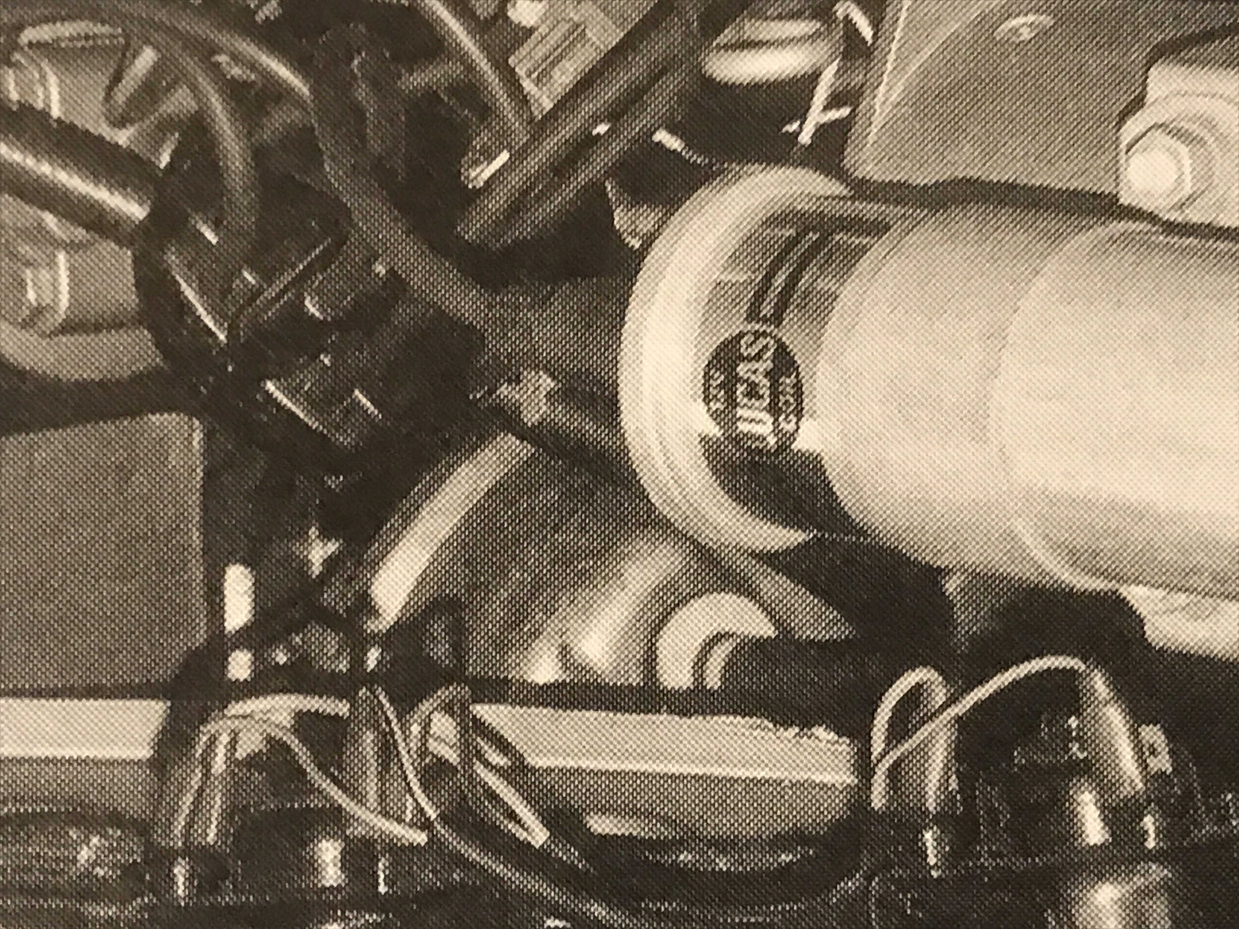

Your servo appears to be a correct Girling Mk2A booster; note how the vacuum line from the manifold is clamped to the check valve. Pics 4&6 from your sequence appear to be of a different servo, possibly a Mk2B but the orientation of the vacuum inlet doesn't look correct. Here are images of the two types:
I have read that the 2B may have been used in late production BJ8s, and as replacements for 2As. My BJ8 has a 2A, and I've never seen a 2B in a Healey.

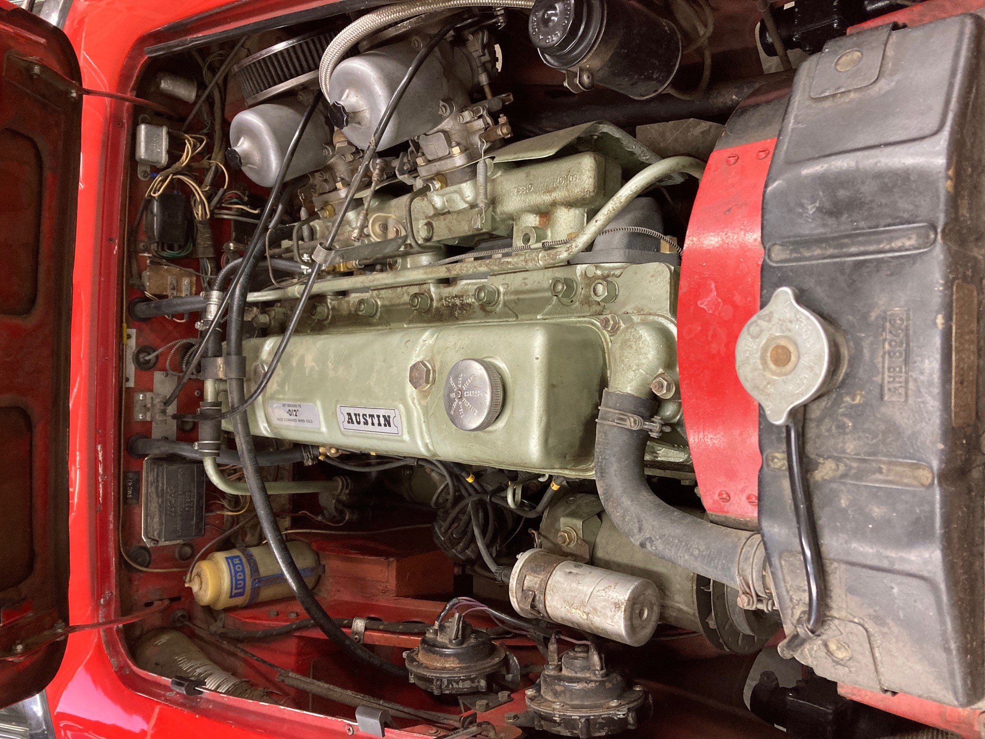

Thanks Bob. Is your hose straight (not pre-bent like Moss's) and routed like mine?
I think last time I replaced the vacuum hose I used regular hose, but I believe the pre-bent hose to be correct (I have one in my parts bin). My hose has been shortened a bit; it can be a bear to get them off after a few years (I recommend putting a little silicone grease on the inside of hoses). I'm not sure about the 'correct' positioning of the support strap; it made sense to me to put it on the 'T' for more support; you don't want the hose rubbing in the valve cover (in a couple hundred thousand miles it could wear through).
My servo ain't pretty; it's got 210K miles on it, and I'm not sure it's the correct routing, but there's a eighth-inch or so of clearance.
