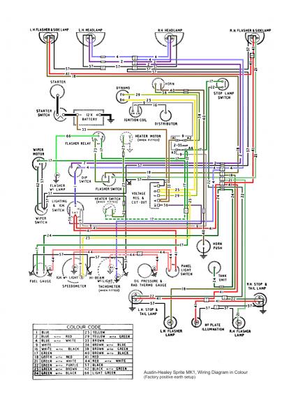

OK, I'll disconnect all the items on the A3-A4 fuse and add one at a time until the 5 amp fuse blows. The wiring diagram I'm using is this one, not Advance.

Update: I disconnected everything and the fuse still blew...tracked it down to 1 of the 3 green wires coming off of the fuse block. Every green wire that goes to anything is taped up with no possibility of touching anything to cause a short, but the fuse still blows. Attached is a picture of the culprit. Thoughts?
Thanks again, Rut

I pulled the fuse holder and its in good shape and not grounded. I traced the 3 green wires to the dash and they are connected to each other by a double connector and the 'culprit' is hot at that point, key on. When the 3 green wires at the dash are disconnected from each other no fuse blows. Also, my multimeter appears to have given up the ghost and the ohm portion will no longer zero.

So that narrows it down.....total of 5 green wires.....one goes directly to the flasher unit, another goes directly to the brake switch. That leaves three to the dash: Fuel gauge, heater, and wiper motor (feed is from the dash). I'm going to bet on the wiper motor.....it is very hard to see the marks on the motor!
