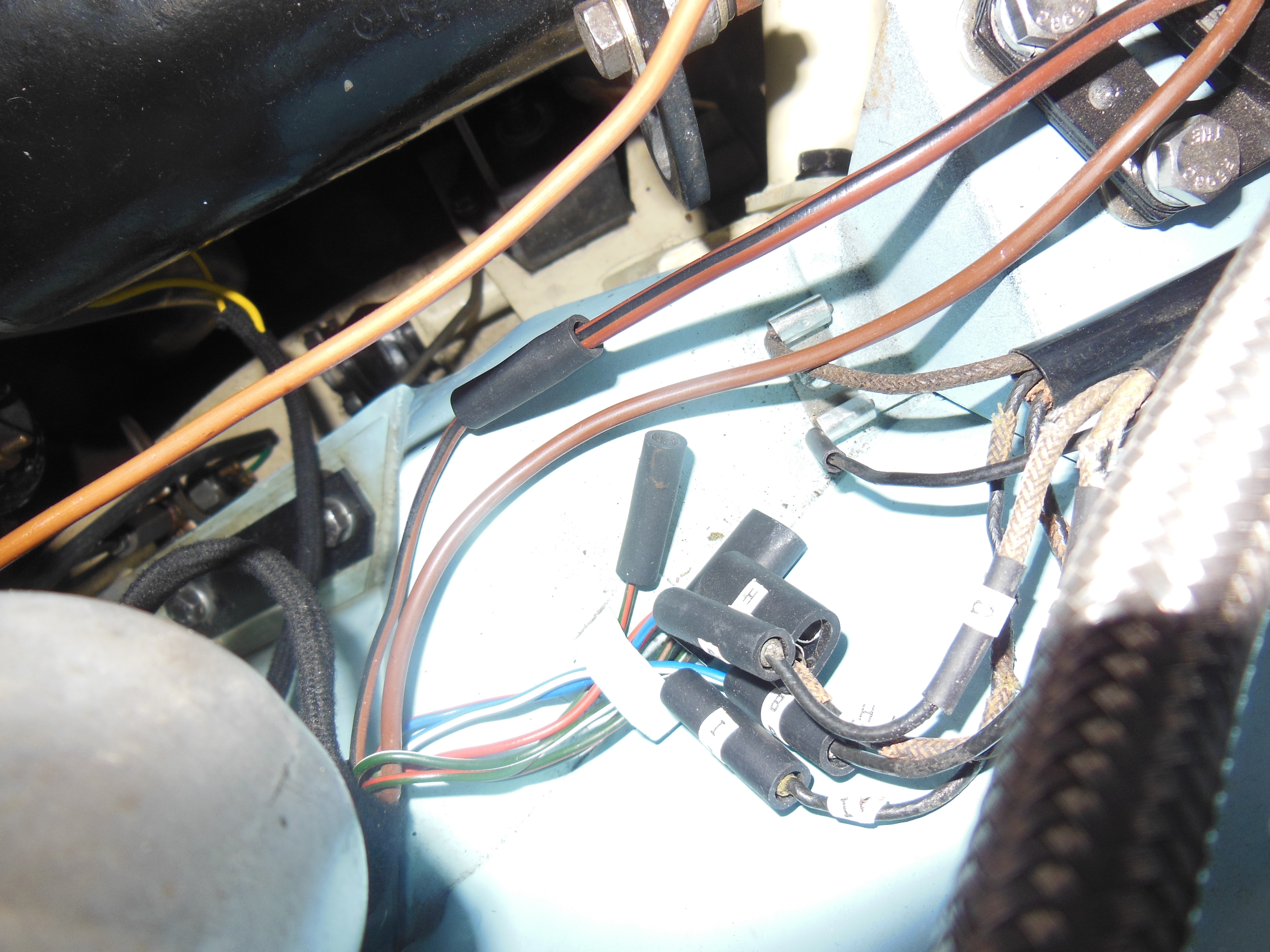

Did you have extra wires in the lighting circuit? There are 3 extra wires in a new harness for side marker lights in Europe. The 3 wires are on the passenger side.
Not that I am aware of. Can you share where this wires are located on the harness? Engine compartment, rear of car? Thanks

In the engine compartment on the passenger side is where the 3 wires that are not used. They are green and red and green and brown. Two of them are hard to see in the pic, but you can see the double bullet connector that is empty if you look close, and the other is clear.

Steve, Thanks for the addition info and photo. The 3 wires you describe I am aware of. I and have it set up as you describe. It was not clear as to why these double bullet connectors were used. Thanks for providing an explanation. One less item to worry about.

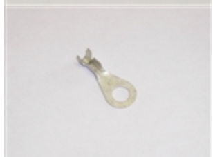

Regarding the green heater wire that is under the dash. Makes sense since the heater fan will need a power source. I did notice something that was not clear regarding a green wire under dash. This one green wire has a eye connector that is currently connected to the fuel gauge. This same eye connector has another green wire. I could not determine the purpose for this second green wire or where the other end of this second green wire connects. Is this the green wire you are referring to? Thanks again for your help.

Not sure about the eye let, but I believe if the wire is green with no strip then that wire goes to the heater. You should be able to trace the green wire back to the fuse box. Moreover, I think the fuel gauge wires are green with a stripe. I thought perhaps you hooked up 2 green hot wires to each pole of the fuel gauge and was shorting there. Does your fuel gauge work? The other place there seems to be confusion is the wiper motor hook ups on the motor itself. I think some of the motors shut off when the ground is switched off plus on the side of the motor there a 2 different hookup that can be flipped . I would say double check the wipers and the fuel gauge.

Good point regarding the green wire I was referring to via the eyelet connected to the fuel gauge. I was able to confirm via the wiring diagram the green wire eyelet I was referring to connects to the fuel gauge and the other end of this green wire connects to the fuse box. The second green wire originating from the eyelet is currently not connected. Based on the wiring diagram for the heater, there is a green wire that connects to the heater fan rheostat/switch. I will see if the unconnected end of this green wire does connect to the heater reheostat/switch. Thanks again for your help with this.

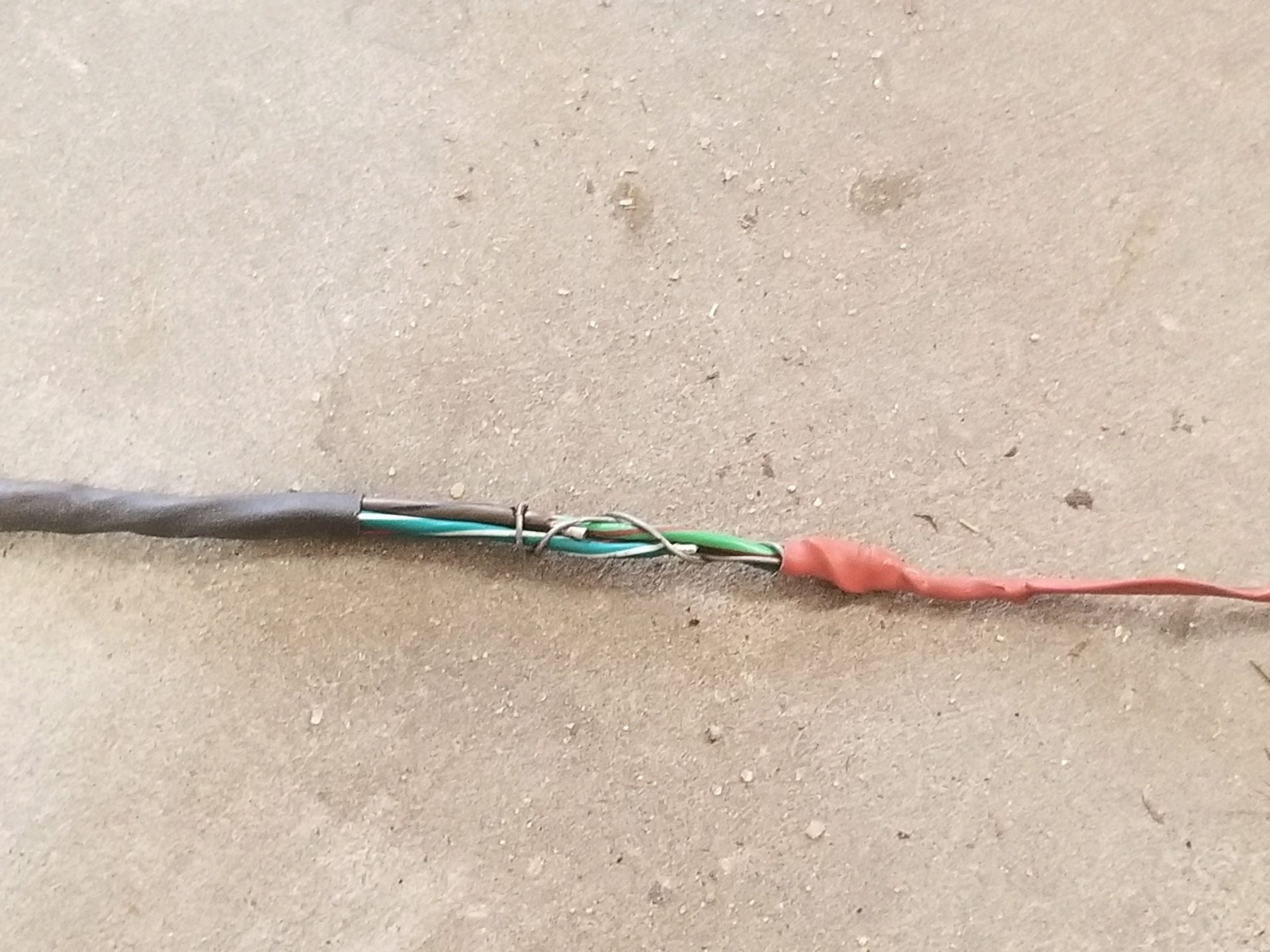

I had the stator tube in place when I installed my control head. I threaded a piece of wire through the tube then removed the bullet connectors from the control head harness. The connectors will not fit down the tube,. Then attached the pull wire to the harness and carefully eased the wires through the tube. Did this with no assistance. A little pull then align the control head then another little pull. Repeat till the control head is fully home.

Very helpful tip/recommendation. If better with the attached photo. Thank you.
