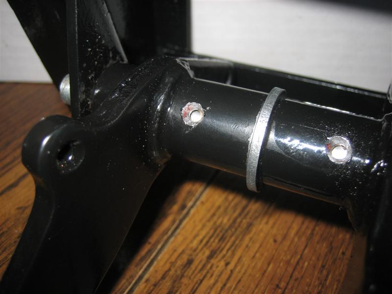

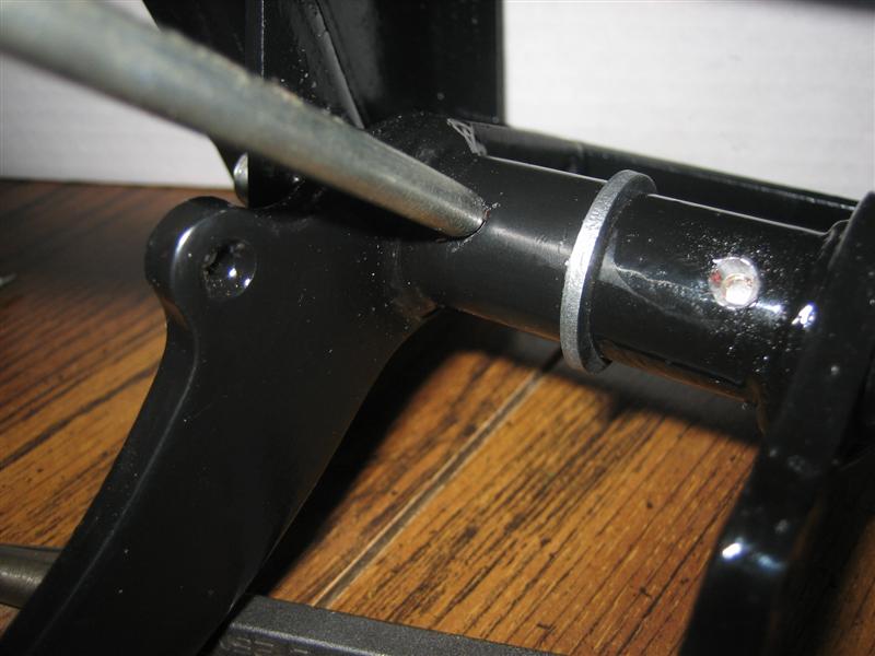

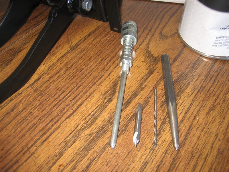

You might consider this small mod to make it much easier to lube.
I have done this to both my Midget and TR6. I have also done it to the door hinges on my TR6 and plan on doing the hinges on my Midget too.
I used a 1/8" center drill to make the tapered hole that fits the grease gun adapter.
