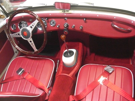

I used the pensburymanor stuff on my BE original knobs, followed by white paint on the letter. It worked very well and I would recommend it!
