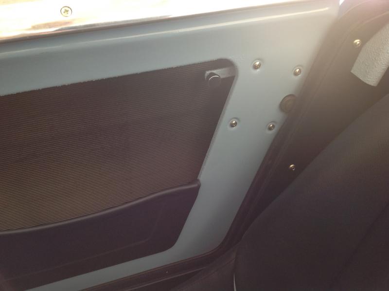

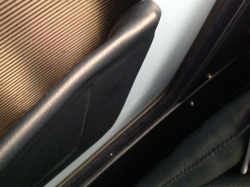

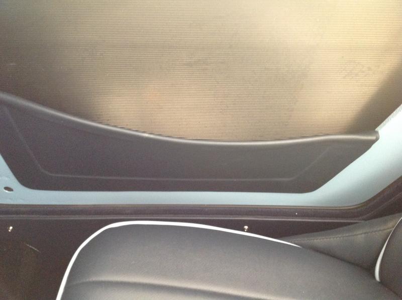

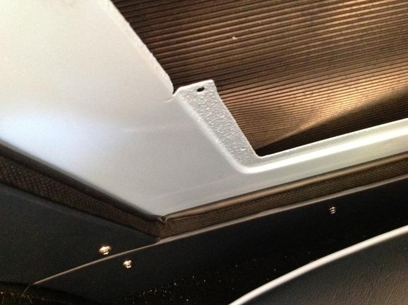

Here you go...BristleFlex on the right side and the AH Spares product on the left. The BristleFlex was a breeze to install, the AH Spares was difficult to install correctly and it's not as secure. They both apply too much pressure on the bottom of the doors, but the AH Spares applies more and pushes the bottom of the door out. I prefer the look of the AH Spares product since it's more like the original in appearance.

I removed the BristleFlex and replaced them with the AH Spares units and they initially pushed the doors out at the bottom, but after being compressed for a couple of days the door fit is better. I must say that the aluminum 'grippers' that go over the flange around the door opening are one step above a pos and the BristleFlex is much better in that aspect. You need to be very careful when installing them and take special care going around the 2 inside corners where they tend to twist and bunch up.

I would assume that he only makes one BristleFlex in different colors. It's a nice looking product, easy to install, works well...just not the correct look.
