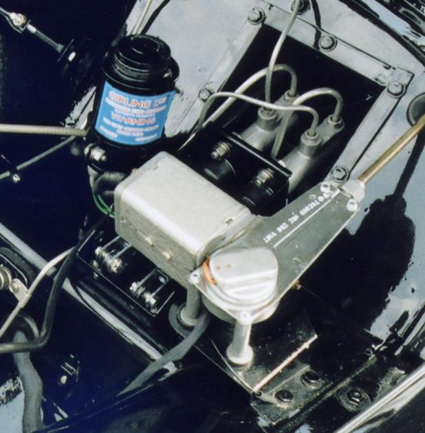

In over 21 years with DOT 5 purple silicone fluid have I ever had any paint come off. If it got soaked because a gland was not sealed tightly, I would just wipe up the oily mess from the paintwork. And that covered 105,000 miles with no issues like you describe. Maybe your painter didn't prepare the epoxy etch primer, the primer and the finish colour correctly.
