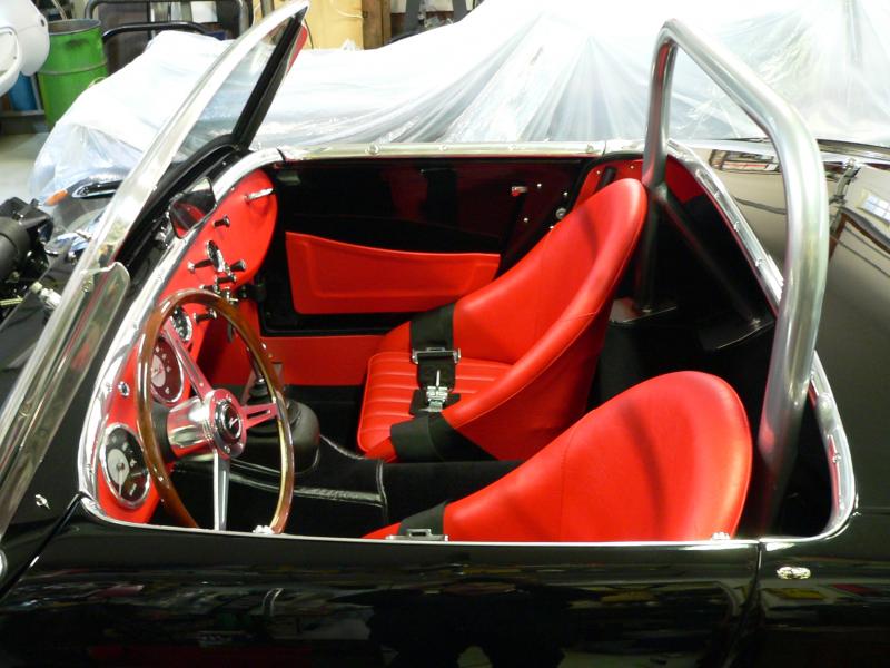

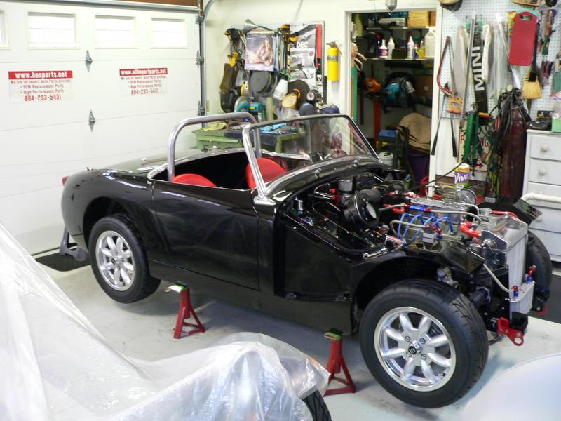

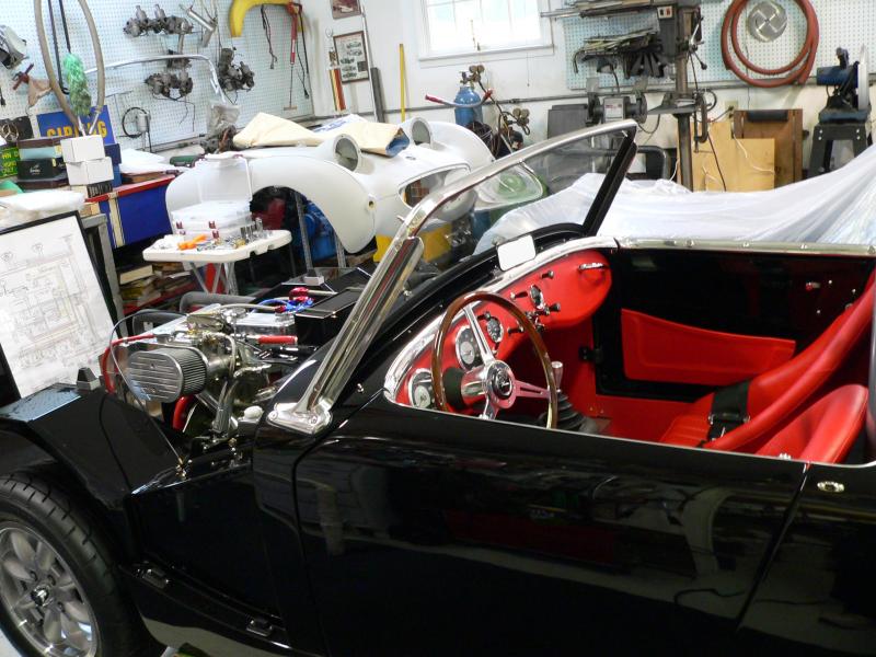

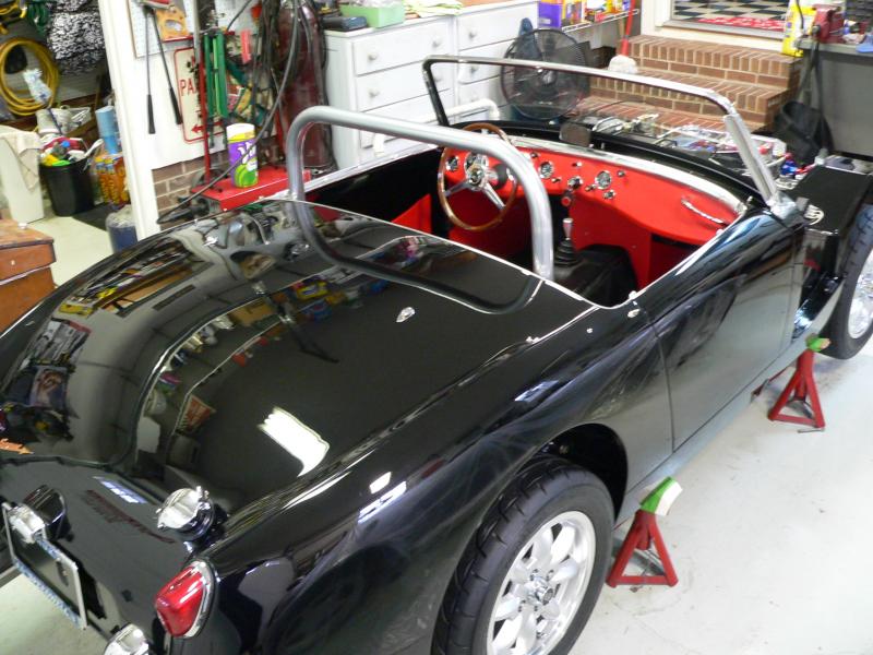

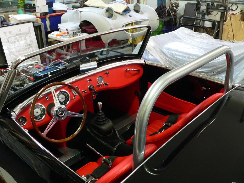

Finish installing doors, on with next and final part, THE BONNET "ARDUOUS" :devilgrin:
