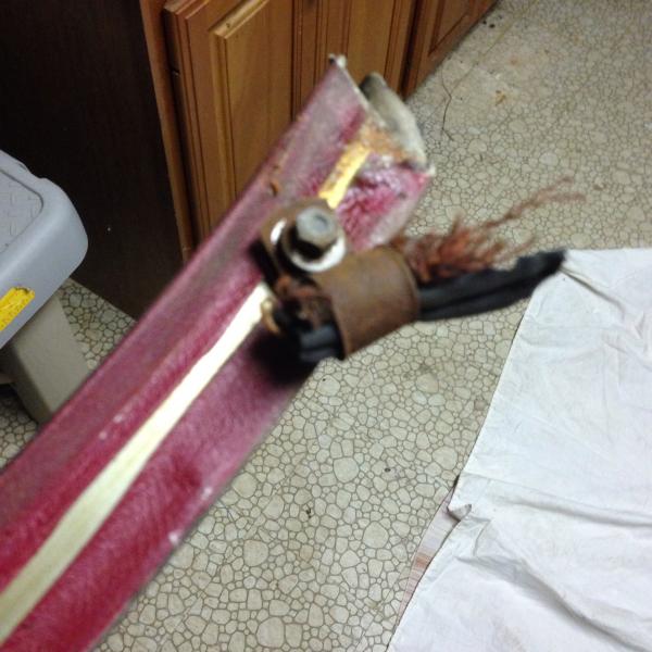

Rhodyspit75
I found these clips with what looks to be the remains of the door seal. They are held in place by the two outermost screws on the cockpit surround above the dash.

bugedd
bugedd
its pretty simple, I just got one side done in about 30 minutes after removal of the old seal. The "P" clips if they are missing can be found at any hardware store. The ones I used were 1/2" plastic coated ones from the bike shop, used to install rear bike racks.
