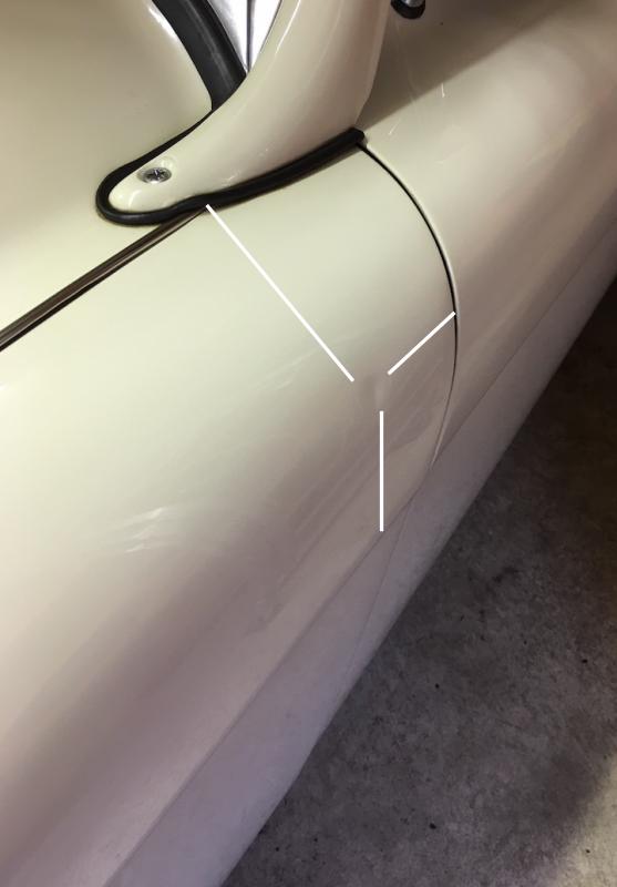

Update: I met with a PDR technician, who came highly recommended. Good man, experienced, who previously restored a number of award winning TRs. Many of the things he said echoed Ausmhly's comments. He could see no easy way to fix the dent and a dent on a curved surface would make it especially difficult. Entry from below did not appeal to him because of visual access and leverage. Entry through a hole in the wheel well did not seem doable because the dent is so far aft (it's very close to the edge of the door). A hole through the side bulkhead beneath the dash would not provide the necessary visual access or leverage either. He would not use glue tabs because of the age of the paint. Looks like I'll just have to live with it unless I am up for removing the fender. Interestingly, the PDR guy said fixing the dent with the fender off would present challenges as well (leverage issue). He made me laugh when he said he's busy been fixing dents made by acorns falling from trees!
If you were to ask him, if I remove the panel and clamp it to something so it's solid and put something behind it so you can get leverage, can you then PDR it? I would say YES! So should he.
With your help, a little skin in the game to get the wing off, not a 5 minute job, you'll get the dent out in the best possible way...PDR. No worries about paint matching, keeping original paint etc. He should be able to do the repair in about 20 minutes.
Ausmhly, I did in fact ask about doing PDR with the fender removed, and he stated that once removed, the part would need to be properly braced and secured, with a means of providing the necessary leverage. As someone experienced restoring vintage Brit cars, he noted that removing the fender and then remounting it 'straight' with all the gaps right might be challenging.
IIm with AUSMHLY
Guess fixin acorn dents just so much easier to do ?
He's mirroring exactly what I've said.

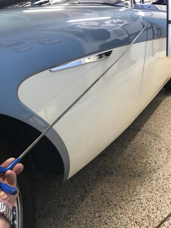

Let me see if I can figure out how to get a tool to your area on my BJ8. I've photo shopped your dent. If you care to provide the measurement in inches or mm for the three lines, I'll transfer those to my BJ8 wing and see it there is a way to get a rod to that area. I already know the wing rolls over on itself going towards the front, so access will be a challenge. I'm confident I'll be able to figure out how to PDR this.
Thanks...about 4.5" down from fender bead, 4.5" up from swage line, about 2.75" from rear edge of fender. See pic for more...

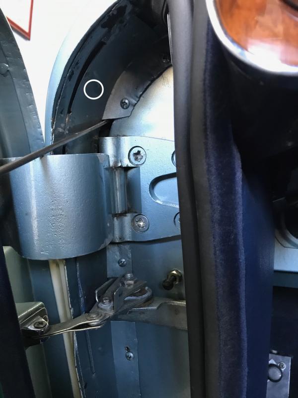

I've marked my car having the dent in the same place as Nevets, and I can get access/leverage to the dent with that PDR rod in the photo.
If you have access in the same place as me, good to go.
If not, I'd drill a small hole where I've photo shopped the white circle, slide my rod in and work the dent out. I'd put a rubber plug in the hole after.
The plug would not be seen when the door is open.

I've marked my car in the same place, and I can get access/leverage to the dent as shown in the marked up photo.
If you access in the same place as me, good to go. If not, I'd drill a small hole where I've photo shopped the white circle, slide my rod in and work the dent out. I'd put a rubber plug in the hole after.

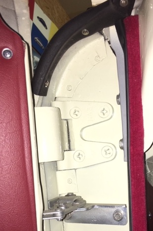

Ausmhly, looks promising. My BN6 does not have the same access opening (see pic), so a hole would have to be drilled. I will give it more thought and discuss with the PDR technician.

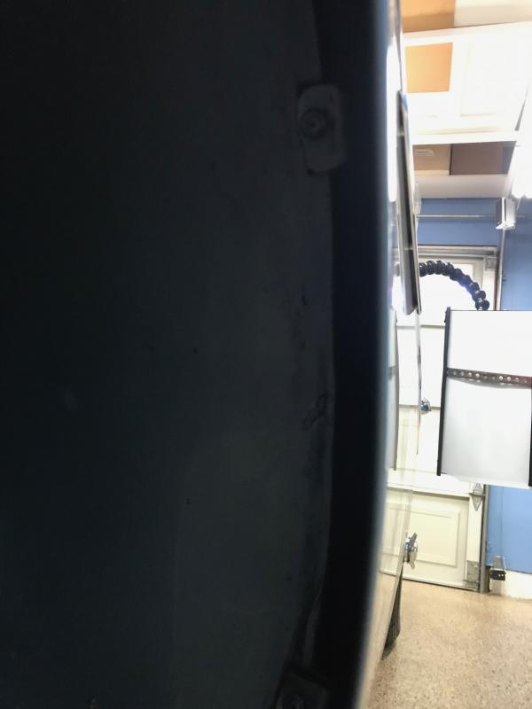

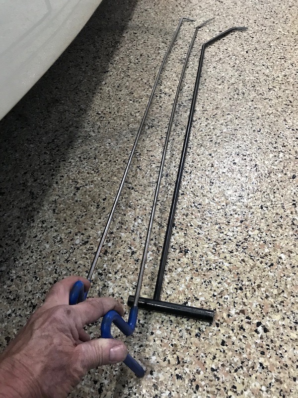

Your PDR guy might try from the front wheel. I have access between the wheel well and the wing. I can get all three of these rods there. There seems to be in inner brace at the dent location that provides leverage right there.
If not, then have him look into drilling a hole where I suggested in the wing at the door entrance.
