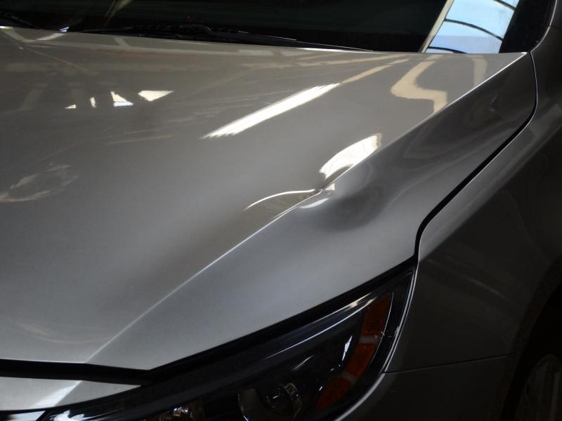

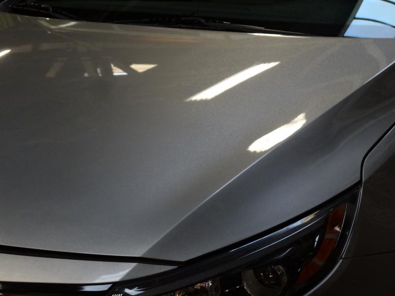

Example: Here's a dent I did a couple years ago. If this was repaired at a body shop, they would feather into the fender because there's not enough room to feather to the edge of the hood.
