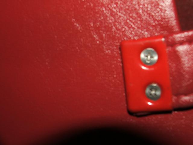

This is a little fuzzy but it should give you some idea.

Hmmmm. Not what I was thinking but that does give me a great look at what it should be. I wasn't around when the paint guys took the straps off but I don't think these were on the car. both straps were broken which led to some significant body work :frown:.
Thanks for the picture
Erik
Nelson gave you a nice picture of what is supposed to go over the strap but there is another little plate that goes under the strap. Check a Moss or VB catalog.
Kurt.
So there are two pieces and the strap sandwiches in between? I will have to look through the bin of parts to see if they overlooked these. I will keep better track of Everything next time.
Yes, you've got it now, Erik.
