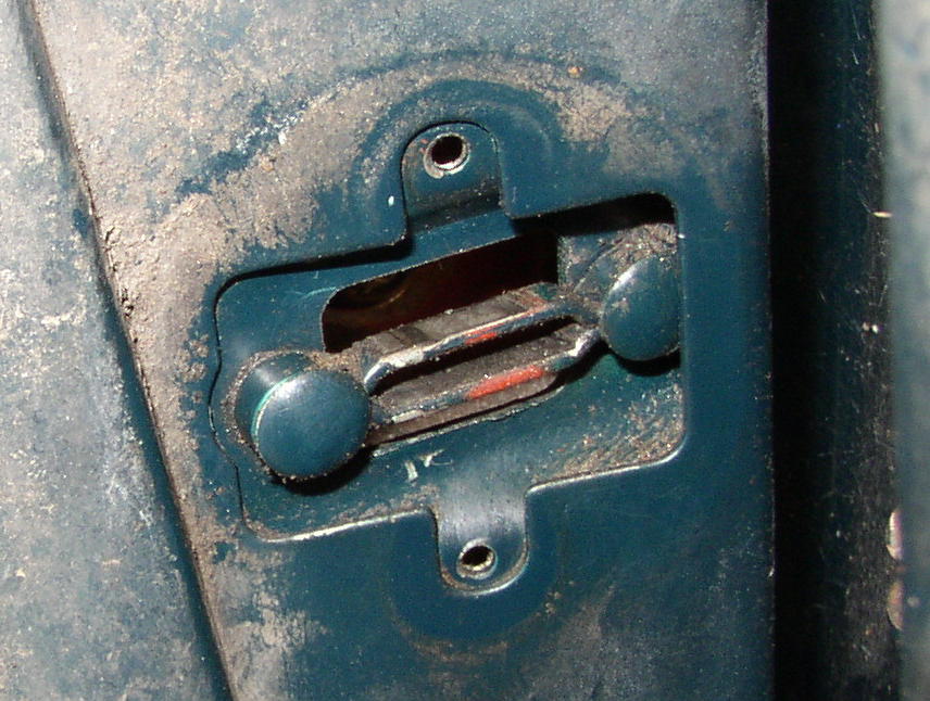

Kodan:
Thanks, for door stop info.
I got 2 new door stop arms a few weeks ago and have
been trying to design something around the door hole.
Both sides of my car exterior have scars where the PO
was too lazy to install the door stops.
A photo attached of the door area in question
tin
Yipes, looks like you may have to dissassemble the door to put new equipment in the strap hinge...
good luck let me know how it turns out.

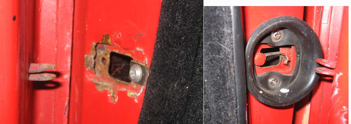

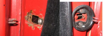

Tinster, Looks like all you need is the spring clip that holds the door open. It is item 4a referenced in the Moss link provided by Kodanja. I have attached a pic of what the door post opening should look like with the clip installed.
69 TR, my driver side door hinge that connects to the check strap wore through and broke. This hinge was originally installed and welded from the inside of the door. I have not found a source for this door component, so when the times comes to reskin my door, I will fabricate a new hinge, grind off the old stub, then weld it in.
