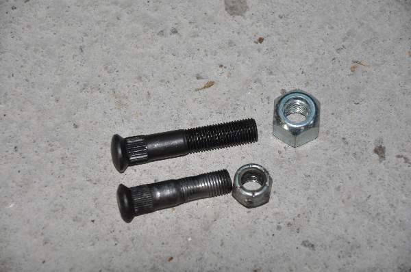

The little nylocks are sooo weak it ain't funny.
I'm installing longer studs and lug nuts instead.
On EVERY corner!

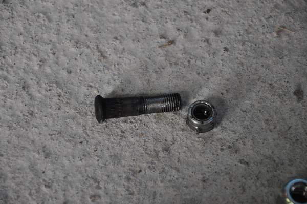

Note the size in one pic ( I removed one from the other size so you can see the weak little suckers). The stripped stud is one of the ones that gave up.
The other pic shows a regular lug nut for comparison and
the longer studs I'm installing.

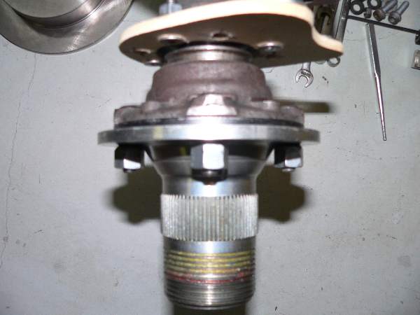

Pic of new beefier mounting of the wire wheel adapter
via real lug nuts. Install should be Sunday.
Alan discovered the hub bearings were not fully seated
and fully seating the bearings gained some stud length available. This means I don't have to install new studs on
the driver's side. The passenger side studs were toast as the earlier pic shows.
