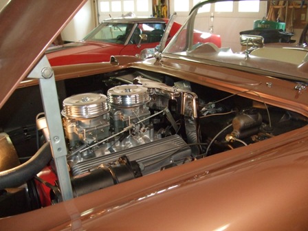

Hi Guys, I'm kind of partial to the 'ole '56 I had here for awhile last year. dual quads on a small block Chevy. Corvette that is. Factory original restoration. Hey, please don't get me wrong, I love them all, that's why I own a Healey. Dave. Hope the Pic comes thru.
Boy, that's pretty. Talk about a "wow" factor. Another Chevy small block using dual quads as a factory option were the early Camaro Z/28s. One of the cars I've lusted after for almost 50 years:

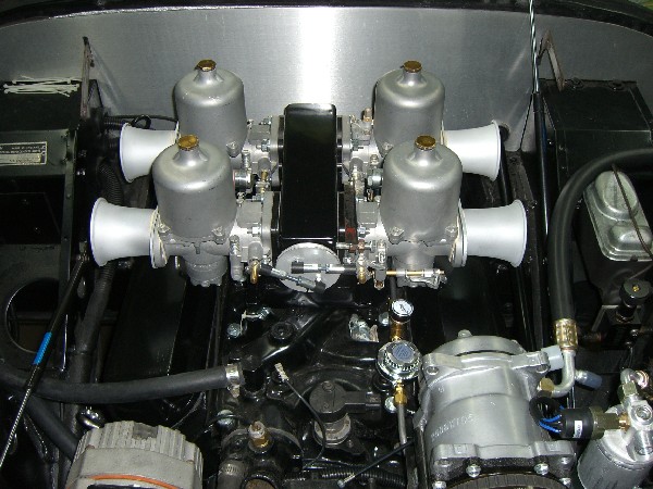

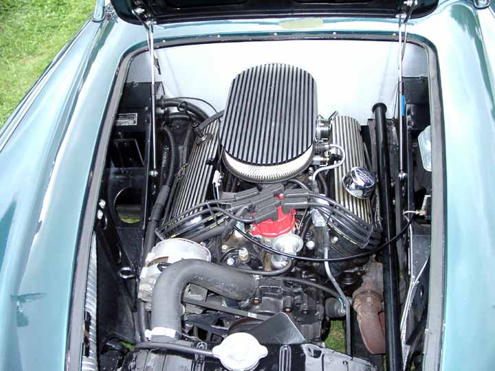

Here is another example of multiple carburetors in a V8 Healey.
I have changed from an Edelbrock 4 barrel
25.JPG Click on picture to enlarge.
to 4 - 2" HD-8s on my 302 small block Ford engine.
4Carbs1.jpg Click on picture to enlarge.
Note also: all electronic, no distributor, ignition and the A/C compressor.
Also running a 4 speed automatic-overdrive transmission, stock Healey 4.10:1 differential and 60 spoke wire wheels.

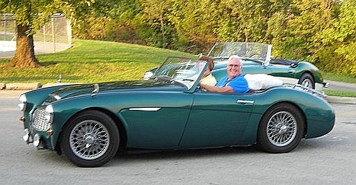

Tim
Tim&Sherry3.jpg Click on picture to enlarge

Yeh man, if you can build it, build it. but do keep a few good ones around for originality. I my case, my Healey wasn't very good or very original when I got it. Wow, 4 HD-8s, that's cool. I'm running HD-8s on my BJ7. They bring alittle bit to the party.
