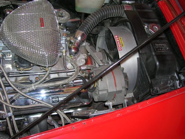

..... have no problems at all changing the plugs on the SBC.
