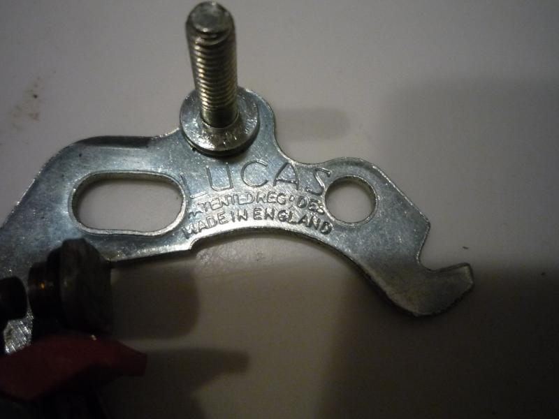

For comparison, here is a set of NOS Lucas points from the 70s. "LUCAS" is in a unique font, with patent statement and "Made in England" stamped in the base.
