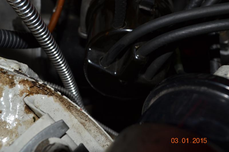

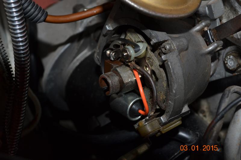

Distributor popped out of the block as it had not been properly tightened by the previous owner I suppose. I cleaned it and replaced the points & condenser. Now I need to put it back in and lock it down. I need very simple instructions on how to do this. Pictures would be nice.
Car is a '69 MK IV with a 1275 and Lucas Distributor. Here are photos before I replaced points and all.

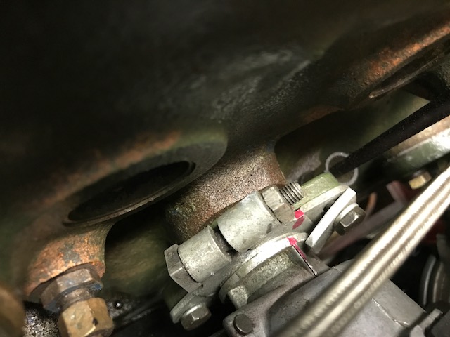

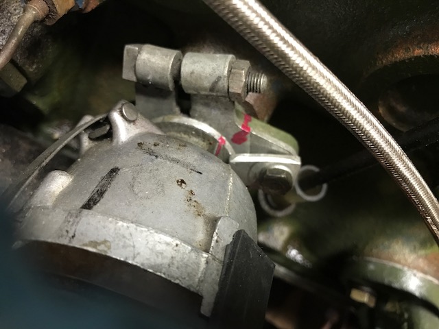

Just took these two shots, I hope they show everything clearlyIMG_0251.JPGIMG_0250.JPG
