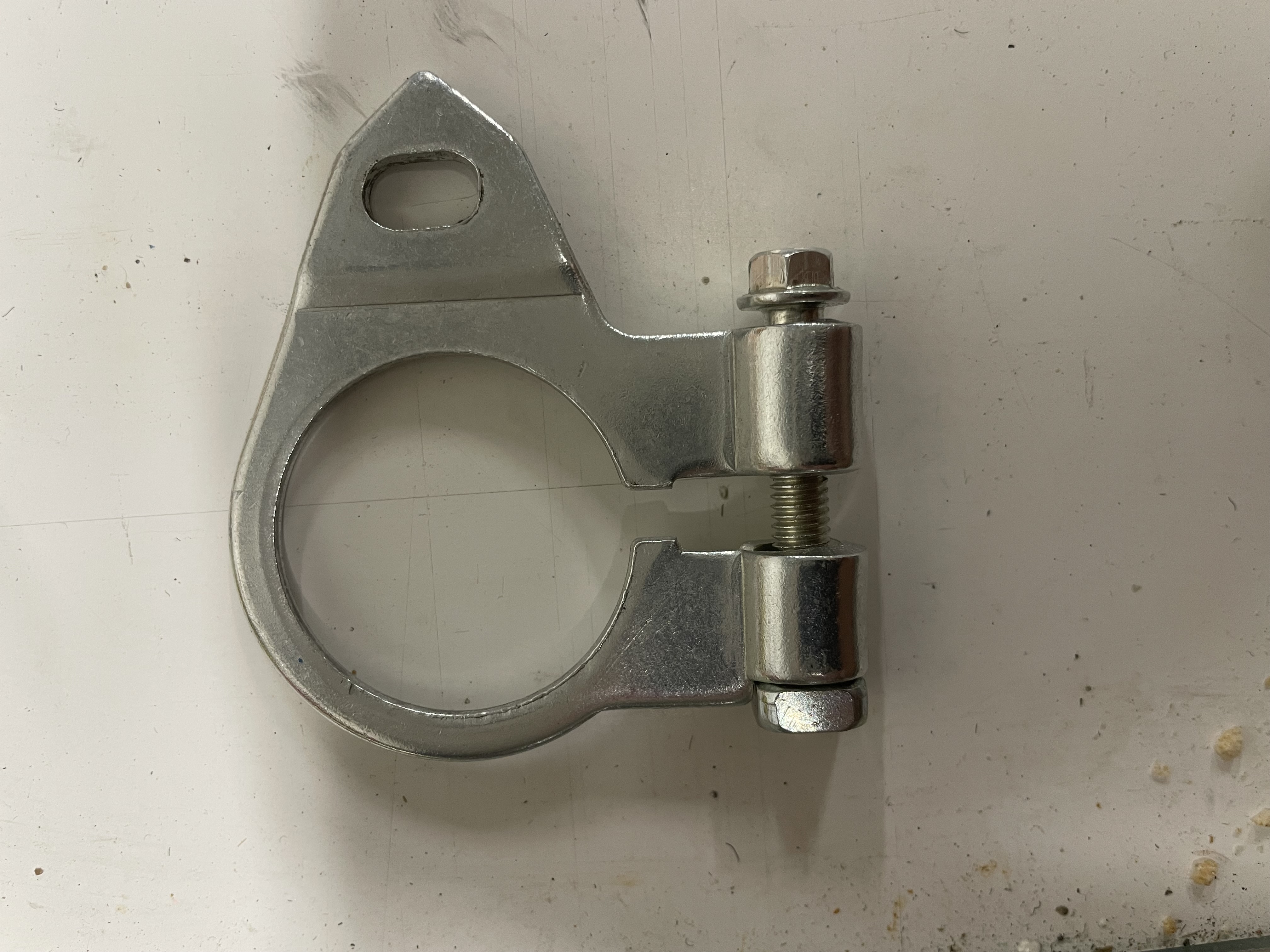

Not totally on point, but there seems to be a gap where the pinch plate is on the distributor pedestal.
I actually had quite a problem tightening that plate recently. No matter what I did, the distributor would rotate under reasonable force. I actually stripped the nut and bolt on the pinch plate, trying to get it to squeeze the distributor more tightly.
I also note that Moss is supplying a different kind of pinch plate for the pedestal, at least that’s the case with some new distributors. Here’s a pic for you to review.
Let me know if you would trust it. It uses only one side for a bolt. Is this yet another instance where someone thought they had a “better“ idea?
When you look closely at the pinch plate you will note that the bolt hole side is not level. This is on purpose and must be mounted to elevate the plate. The distributor has two different diameters/ steps where the pinch plate contacts .
It sounds like you had the pinch plate upside down. Therefore it contacted the wrong area on the distributor. This prevents the plate from actually pinching the distributor.
And I know because I did it just a few years ago.
Charley
Thanks Charley. I checked and had it right side up, but because I checked, I also could see the distributor wasn’t seated fully. I reinstalled, but this time put the plate on the distributor first, then lowered both into place. That way I knew I had it right.
