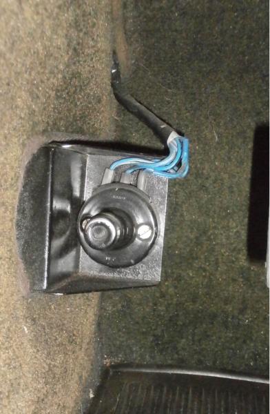

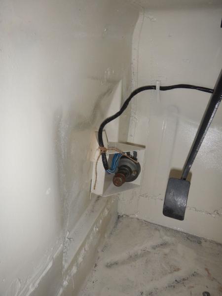

I have installed the dipper switch as it seems it should go but I feel the wires are exposed to damage. Should the bracket be flipped over so the switch is mounted on the flat surface?
The tag was my way od identifying the parts of the loome
David

Yes, I believe the bracket goes the other way.
It should have a hole, so the body of the switch goes inside and just the button sticks out.
But, there were several different types of switches and several different brackets. So its possible yours doesn't have the hole for the switch to stick through.

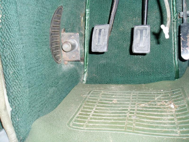

Here's mine:

I think the switch,bracket and installation are correct for a post 60K car.
If you route the wires as shown in my photo, it is impossible to step on them.
The switch itself doesn't compress enough and the slanted top & bottom
edges of the bracket complete the "shield' of the wires.

The changes in the mounting bracket must have been cost saving ideas. No hole less work.
Frank
Thank you.
I think that will work. I may try to tie the wires back to the switch mounting screw with a tie-wrap.

I second Frank’s picture that is the way the later ones are as odd as it seems. There is a kinda interesting deal/story about the early ones like in Tom’s picture. The rivet is in the center and that is where my foot would rub and because the rivet sits high and the canister is spring loaded if the rivet head wears down the last click will let all guts shoot out and shut the lights off-- maybe that is why they changed. Just a guess.
