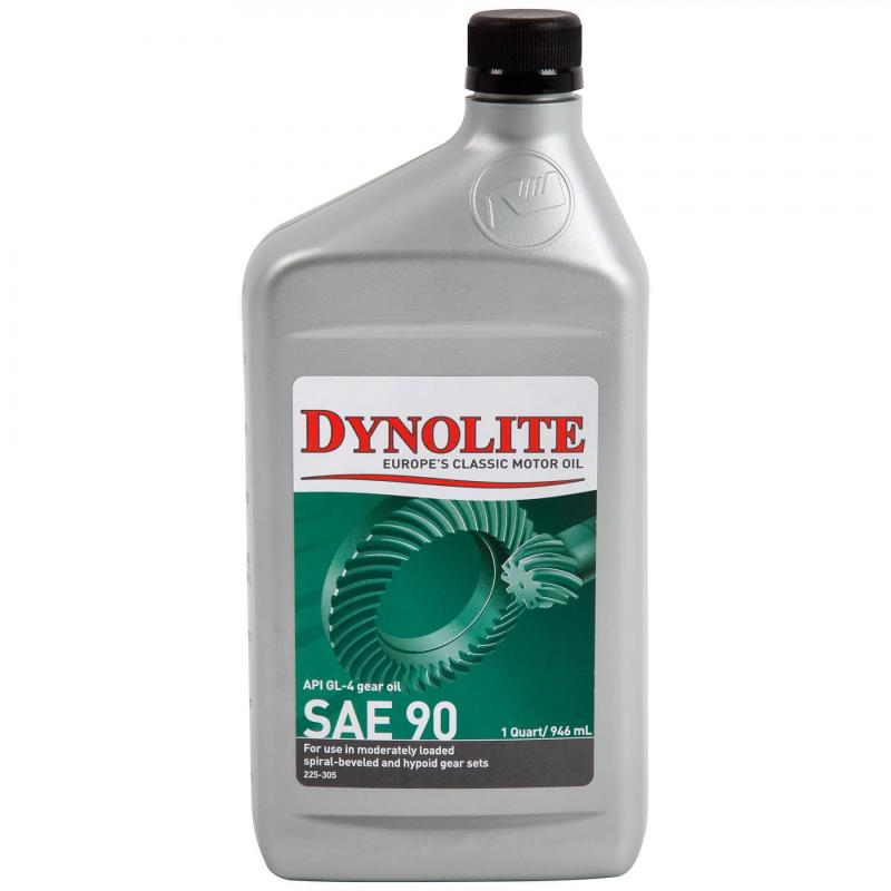

Moss motors sells a straight 90W GL4, Dynolite. Description:
Our classic cars require special fluid and oil formulations, in particular, gear oil. Newer GL5 oils have too high of a sulfur content which erodes yellow metals such as bronze or brass, which are commonly used in British applications. Our cars require a GL4 type oil and this Dynolite Gear Oil is perfect for our classics.
Not that hard to find after all! :wink-new:

Hello everyone. Having observed a recent drip from the pumpkin, I'm going to change the diff fluid. At the same time I'm installing a new drain plug that will be wrapped in teflon tape. I'm bringing this discussion back to the top to discuss what fluid to use. I'm asking the group to revisit this issue due to the claims that GL5 additives (sulphur) cause damage to bronze, copper and other bearing and thrust washer metals. Because of these claims about GL5 fluids, I'm inclined to avoid them. The Moss Dynolite 90 seems to be the right product for the Healeys. It has the exact manufacturer recommended viscosity and the lower sulphur/phospate content. I suspect it is for hypoid gears, or else Moss would not market it as such. I guess I could be wrong about that. Anyway, is anyone aware of any alternative that meets these three concerns (hypoid safe, 90 weight, lower sulphur content)? I also wish to avoid products that are more likely to seep out of the pumpkin or drain plug, so I guess that is four concerns. I look forward to your contributions to this discussion.
