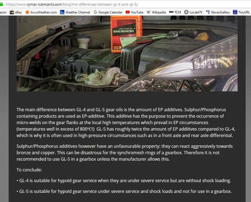

I wasn't sure myself, come to think of it, so I did some googlin' (I usually trust RL's descriptions):
https://www.rymax-lubricants.com/blog/the-differences-between-gl-4-and-gl-5/
Also, I think we should use the 'NS' version, since the other is more for use with limited slip diffs, as the LSDs basically have a type of clutch and friction is a factor (but I doubt it matters diddly-squat in our old-school open diffs).
