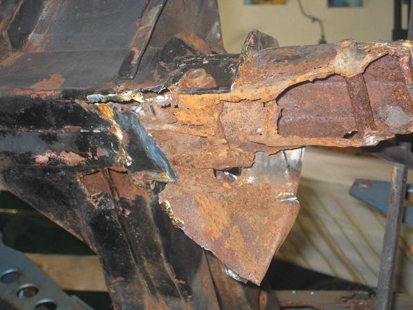

Thought you might like to see this to make you feel better. This is what the front of my frame rails looked like after I peeled off the awful repairs.

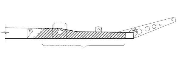

Well Neil, I haven't tackled your specific situation, so this is just my opinion. I'd cut the frame rails midway through the outriggers (the green line in the diagram). That might give the best support from the crucifix, plus the outrigger would give support also (see the blue blobs for the welded areas). As for rear frame pieces, I didn't see any in the Kilmartin catalog. If your interested in originality, the toughest part is the seam that runs along the bottom. For the prices I see, I'd make my own rail and not worry about the seam.

I think I will make my own. There isn't a steel tube with the correct section dimension to start with is there? Would you brake a 16 GA sheet into a 3 sided channel, then weld in the tapered top portion, or just continuous weld the 4 sides of the tapered tube?

In you case, because there appears to be serve rust damage as well as accident damage and possibly poor previous work, I would suggest that you take all mechanicals and attached panels off the car then sand blast of some sort of media blast the frame and what not to see what you really have.
Vette, Yes- The more I look on the frame, the more I find, but the major problems seem isolated to the outriggers and rear portion of the frame, which I will replace. I want to structurally fix the obvious, inhibit future rust, and drive the car often. Maybe someday when my children are older I'll install the Kilmartin frame rather than patch the original.
I wouldn't be surprised if there is a stock tube in the right size, 4"x3" I believe. Here is a diagram of what I'd probably do. I would also go with a little thicker wall, probably 14 ga.

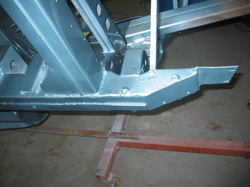

Another suggestion. Note here that I added gussets to the rear outriggers and to the cruciform. It's easy to do, and adds overall strength.

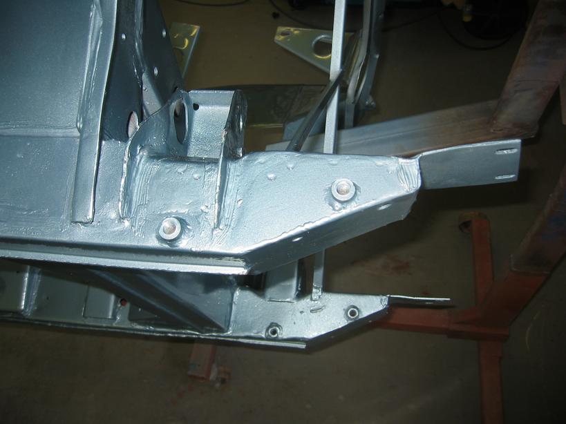

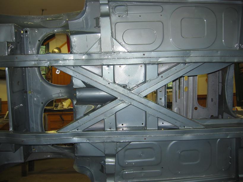

That's just the usual improper jacking damage. I looked at all those places as I was fixing the frame. They could be pulled out, but I didn't deem it worth the effort. Posting those pictures is like posing naked, I know, but what the heck? Before painting, I did have the chassis, with body panels on and engine and running gear attached, put on a frame machine and had all adjustments made to align everything. Then I disassembled everything and had the chassis painted. Finally I reassembled everything and had the whole car fitted and painted.
