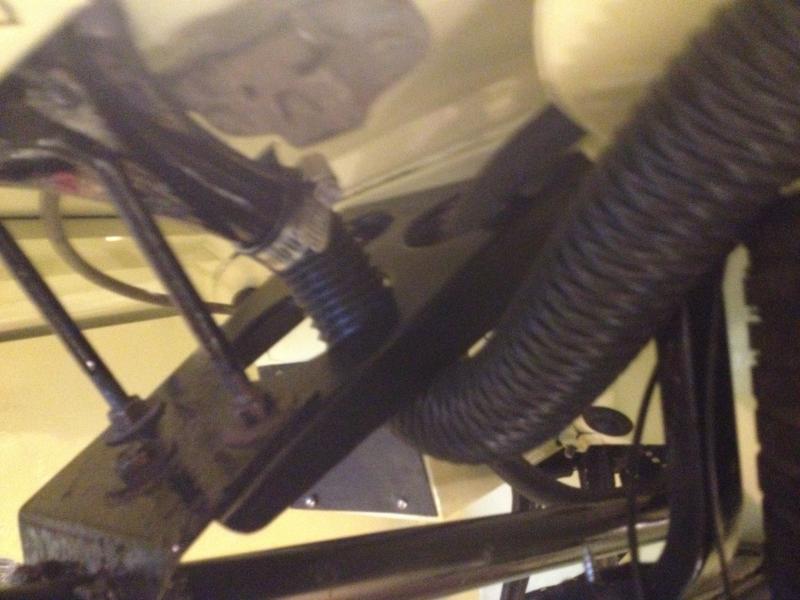

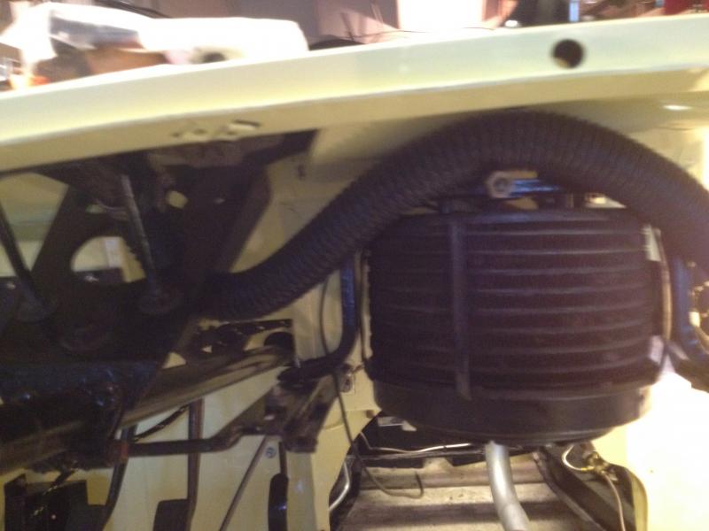

I am looking for the route for the duct to the left hand demister vent, and not having much luck. over/behind/ under the original heater core? Photo would help a lot.

Thank you both. I will put it together this afternoon , and hopefully get a photo to post to see if it meets with approval. Methinks it will look like a cat's cradle!
( Does it go down through the steering column bracket first?)
Michael
her are two not so good photos of the duct as it goes over the top 9 well really, jut behind the top), and avoids the oil pressure pipe. Does this look right? It won't squeeze through further forward: too much competition for space.
Or should I be using a different duct material?
michael

Those are beautiful photographs, and illustrate more than i had asked for. Thank you. (Missed the link first time round.)
i notice you have done some things differently and will have to review some of my anatomical choices. If I have more queries can I contact you offline?
michael
Actually those aren't my cars but posting from a few active individuals on this board who have been down this path as well- I'm sure they wouldn't mind an offline question but I suggest you just keep posting to this thread and I bet they will chime in. I'd offer more direct help myself by my 3A is stored in New York at the current time so I can't grab any quick photos
