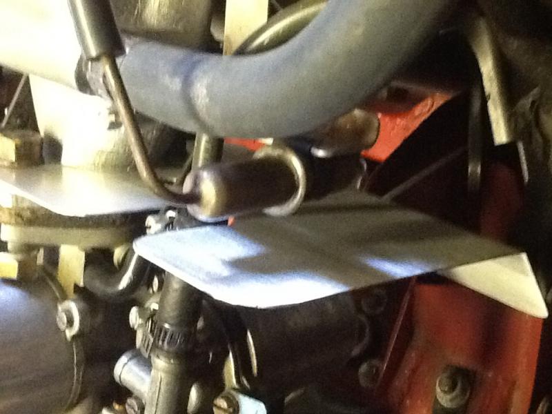

What is that attached to the tube that goes from the distributor to the rear carb?
Beats me but no extra charge. Is it mounted on the the thermostat housing stud? I do see a few other mickeymouse solutions, e.g. battery ground to rear carb mount. In general, the car still looks pretty good to me. Tom
That's a spark arrester. They are factory on the newer spitfires. Lots of different opinions as to why image.jpg hey are there and if the do anything.
