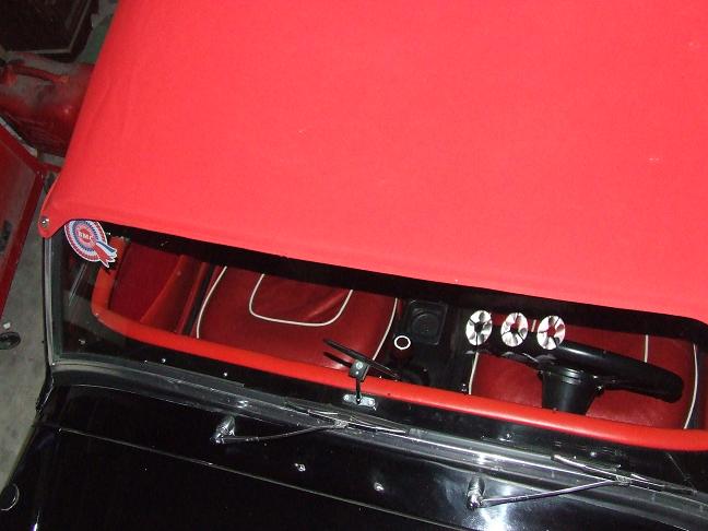

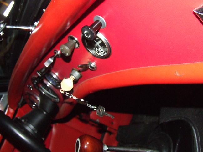

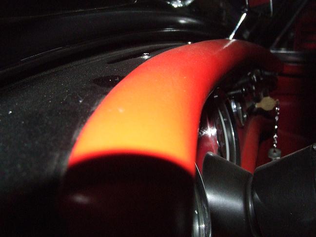

Progress. Pictures here. You can still, after much time spent smoothing over, see a very faint line where radio cut out was. Vinyl is like paint, it won't hide anything! Also there is a seam in the vinyl, runs at an angle right across the main cluster, it is not easy to see in normal light though. Looking good other than that. I have to figure out the best bulbs to run too yet. Currently main gauges are very dim.

Just looked at you pictures-- dash looks really nice but do you have your steering column bezel on upside-down?

I don't know, it's just sitting there so far. I think it's right though, the wire is in the right spot. I'll be sure to check before I bolt it up for good.

Bryan, on your ignition switch. I have the nut on the back side of the dash and a pretty chrome one, similar to those on the switches on the front. Still foggy as to how the dash gets bolted to the car too.
