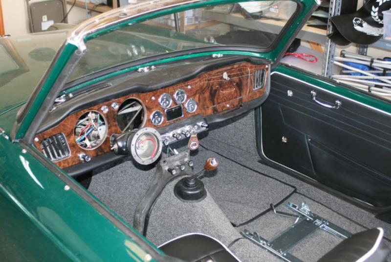

dashcomplete.jpgI used the Moss pads on my dash, they look great, and fit well. I have not compared them side by side with the TRF pads however.
