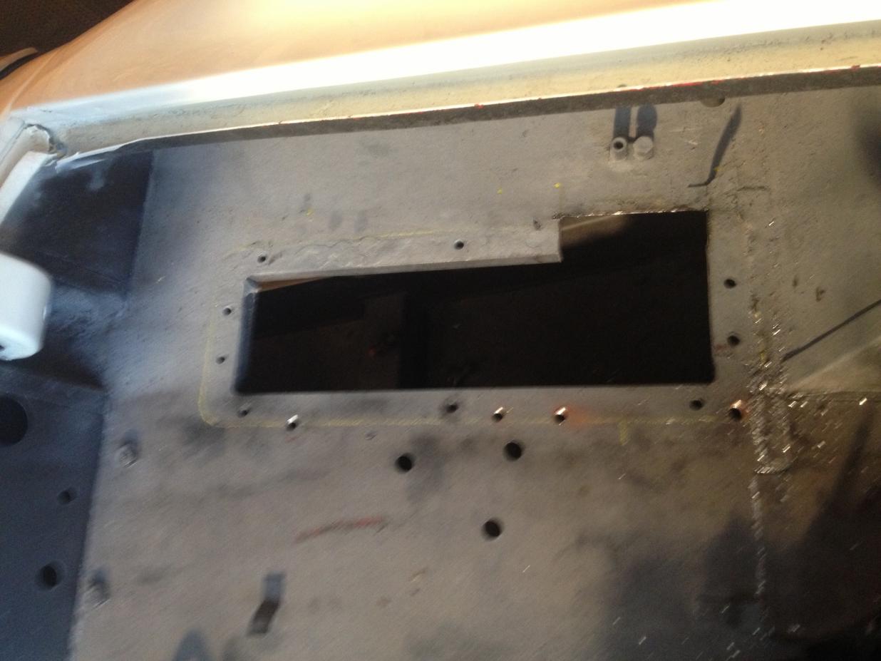

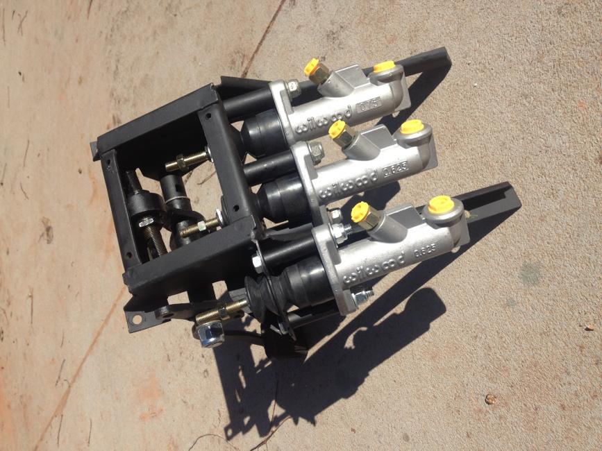

Well I went for it, notched the hole for the later model pedal box and got my new wilwood master cylinders bolted up
