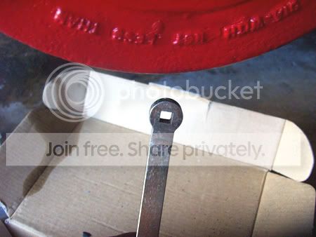

Once you get that, just follow the procedure for adjusting the brake shoes with the adjuster mechanism, using that Square hole wrench.
If you find it difficult to turn the square adjuster, the adjuster is probably fouled with brake dust. You have to remove the brake drum to clean the adjuster. Just putting that out, just in case.
