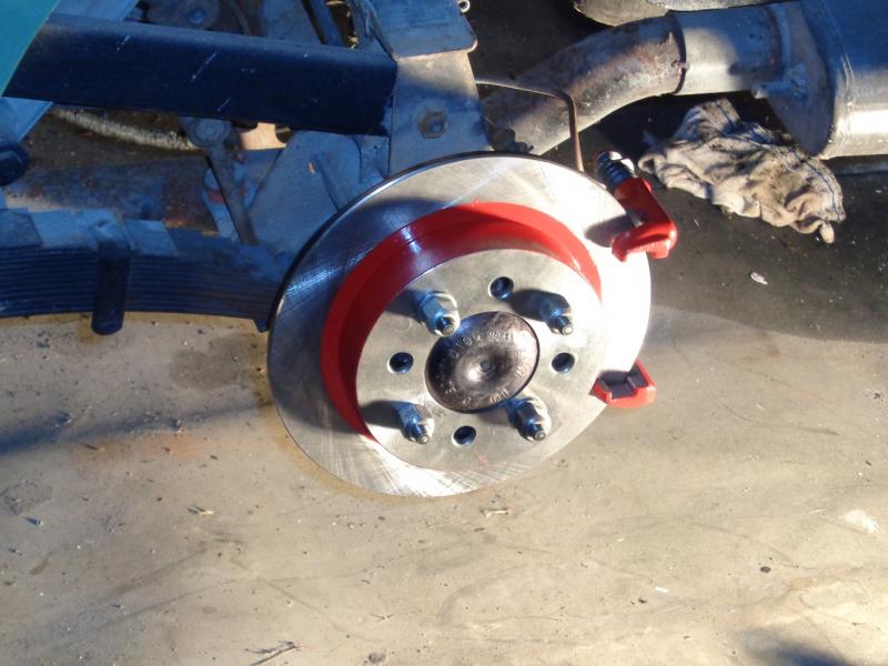

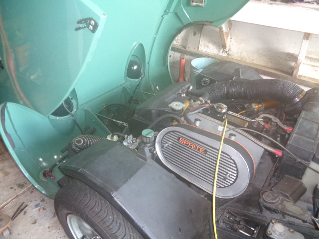

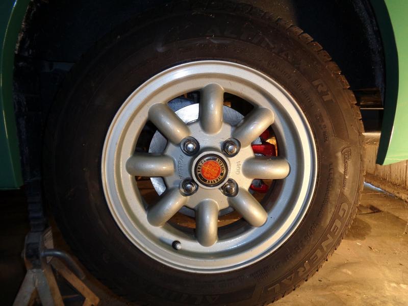

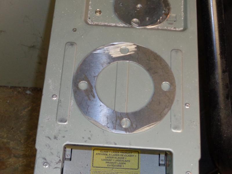

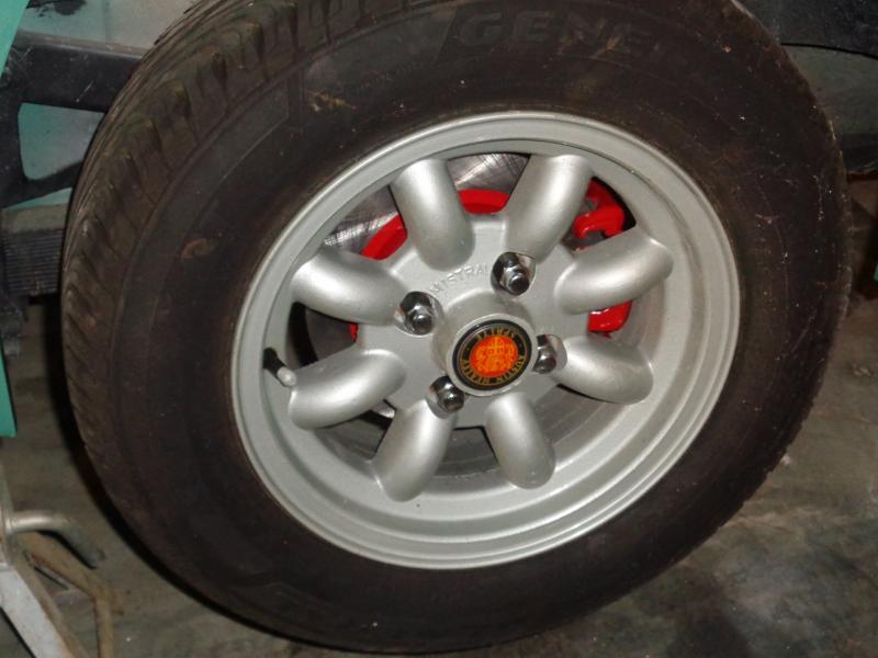

Last February I received a set of the adapters for my birthday from my brother. They were the basis for the latest changes on the Bugeye. We always talked about stuff he wanted done and so it started. Living out in the sticks 90% of the stuff for the brakes came off the internet so there was some waiting time. Everything went together real nice. I had the disc's drilled out at a machine shop. Looking back, I think I spent more time on the spacers for the disc's than anything else but I found the thin aluminum (.020) on the net so I made whole face spacers. Other than that just alot of fiddling to get it set up like I wanted.

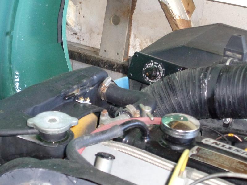

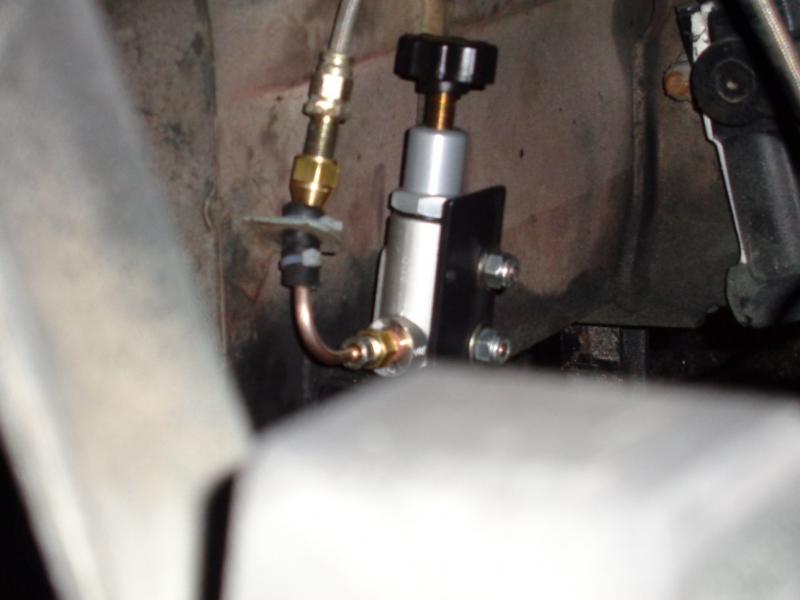

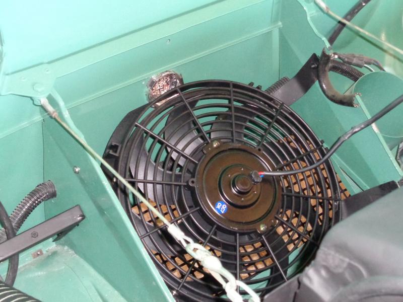

New brake lines, clutch cylinder and line, aux cooling fan and the cold air intake took up the between time on the brakes.

Jim, I helped refine the adapters and made the prototypes. I have all the components to do the swap on my Bugeye, but I have yet to do the swap. If you decide to do the swap let me know and I'll make a set of spacers for you.
Thanks Trevor. That solves one source of problems in doing this the rest appears lots of fettling. I think I really want to do this. Anything that helps to improve braking performance. Still cogitation but I'm pretty sure I want to push ahead in this one and start Sourcing parts and pieces. First I need to tear into the front end and that will start next week. Maybe even tommorow.

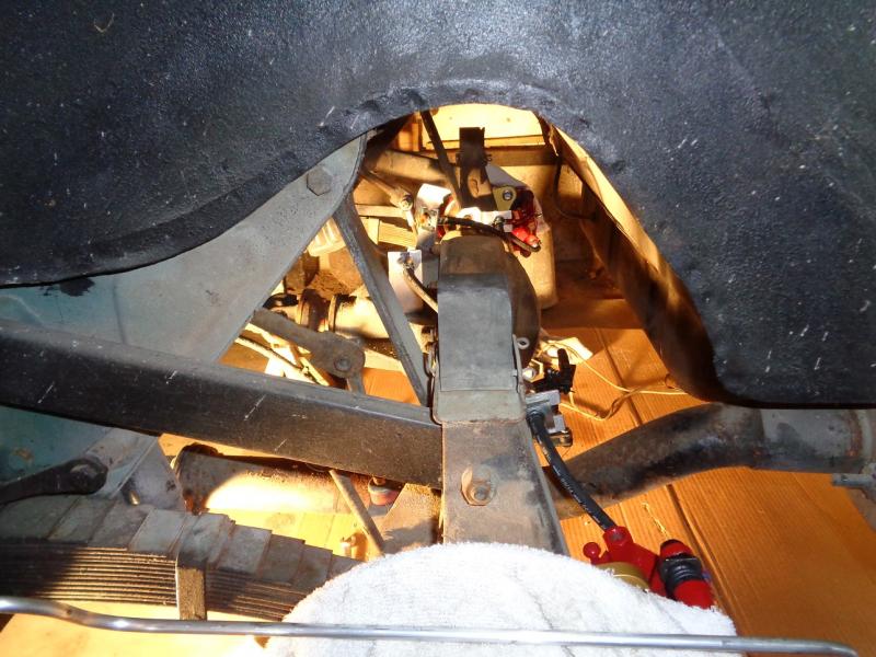

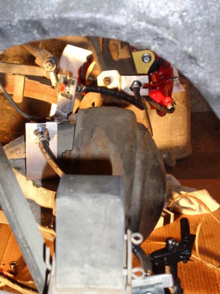

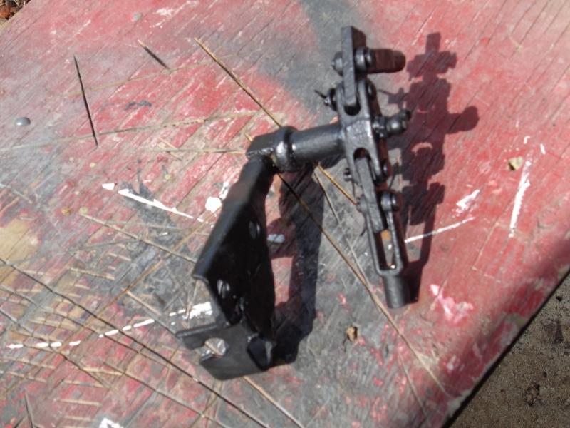

Some Pics for Jim that might help explain what I did.
