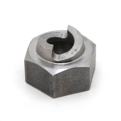

The nut Moss sells looks like those safety nuts that a screw driver can screw on but can't screw off. Different from the one my car. Why is that?

Mine is like the Moss one. The idea is that when the engine starts, it kicks the handle out so it doesn't spin you around, flapping you on the ground until you let go.
Why is yours different? Maybe they figured out that hand cranking wasn't happening anymore and you could now rotate the engine in both directions by hand (when out of the car).

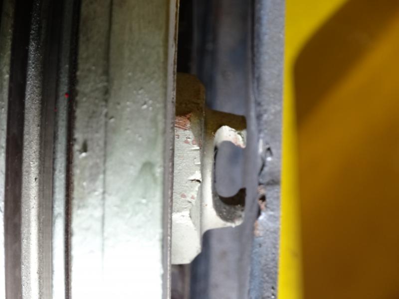

Yeah, the original nut has long, hook-like tines that would actually be useful for catching the end of a hand-crank rod (if only the engine was installed in a car that provided access to it).
The replacement nuts, like the one pictured above, have abbreviated tines that I think are just for show. The benefit of the short/fake tines is you can remove/install the nut without lifting the engine (that is, it clears the front frame brace). With the original nut, the tines get in the way.
True that. Photo shows two dent in the frame brace from the two tines.

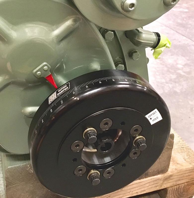

I've hated that ugly nut forever, I finally kicked it to the curb....
