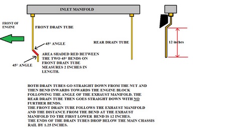

AH Spares sent me this drawing today. I did respond with a few questions and I should hear back tomorrow afternoon.

Well this drawing does not agree with the rear line routing shown on the included [Patric ] engine pictures, My info which tends to follow the pictures, came from a conversation with the late Geoff and some Healey type book that I do not recall the name of. However, it probably will work too---Keoke

I am leaning towards the engine that Rich Chrysler did(the freshly painted one), as we all know this detail would have been something he would not overlook. I'll refrain from saying this is it until I hear back from AH Spares with answers to my questions. I also sent them the photos we have on this thread.

I heard back from AH Spares.
"The diagram I put together yesterday that Julie forwarded to you would be the way to do the pipes if your engine block no longer has the small brackets attached to the lip that the sump fits up to.
If your car does retain those little brackets then the 1st picture of the 3 you attached titled 1-may0701 is as factory fitted.
The bore of the pipes is so small that steel piping would not have been available, also as the pipes help to drain away mainly fuel/condensation then copper is not affected by the water."

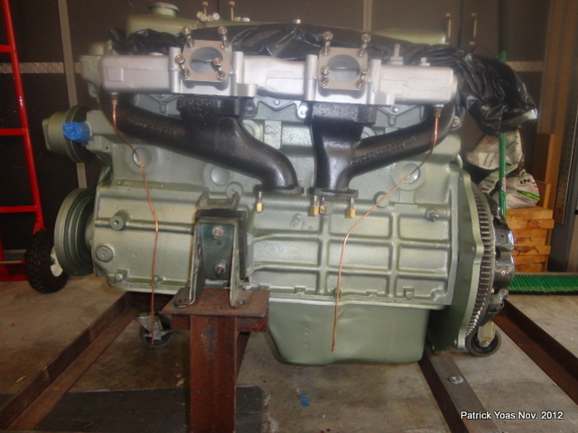

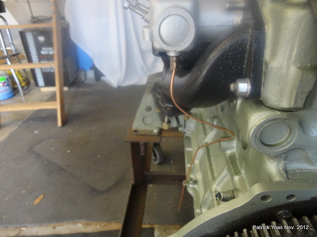

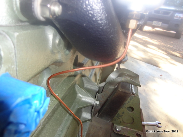

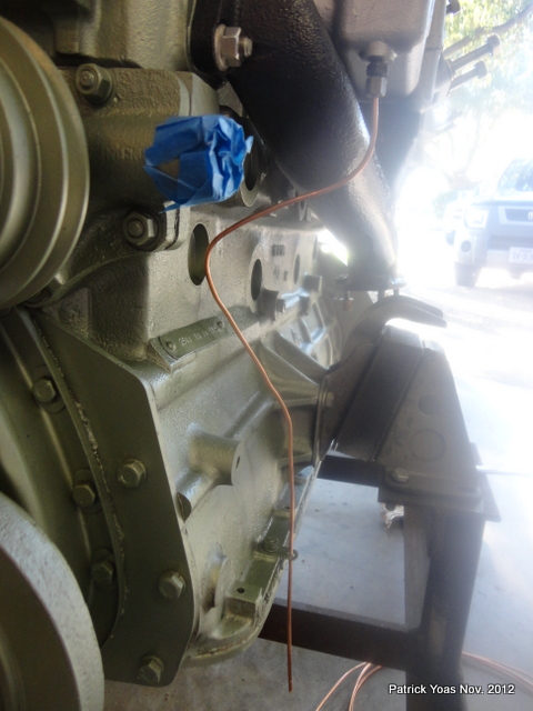

Just finished today. I will be pulling the lines back off to install the correct brass fittings for the Intake Manifold and for painting. Maybe I'll "polish" them and spray Eastwood Hi-Gloss clear? Once they're removed I'll tweak the bends too.

Let me know if there's a particular area that another photo is needed? I'm taking them off tomorrow for about two days and then they go back on with carb Heatshield, etc. on and the lines will not easily photograph.
