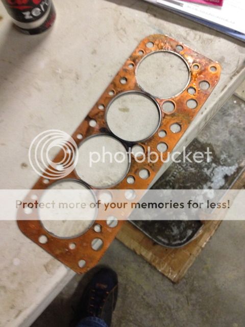

I should have been checking in here more often. I've been having the same symptoms (drive the car 45+ minutes and the top third of the radiator empties itself into the overflow tank, temp soars, it doesn't suck anything back into the system as it cools. 1275 and a crossflow radiator, too.) for the last few, uh, years and finally took it apart (I needed to take another stab at degreeing in the cam anyway) over Xmas break and am just now getting it back together. The life of a high school science teacher, eh?
Anyway, here's what my Payen headgasket looked like when it came off:
Total blow-by from #2 and #3 into the coolant hole between them. I checked the head with a straightedge and it was a bit warped, .006 clearance in the middle. I stripped it and have had it shaved and will be getting it back on the road this week.

You need a Payen composite BLACK head gasket. You have a metal sandwich gasket that are notorious for problems. You also need to remove the brass plug that is in the center and replace it with a threaded plug before the head gets surfaced.
Kurt.
I think the part number is BK450 there is another black payen gasket, but this is the one I've had success with.
