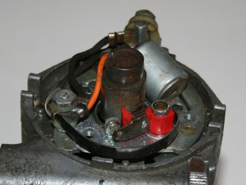

One more thing to absolutely check that the condenser wire is correctly placed with respect to the insulator on the long end of the points spring. It should not be grounded at that point, and it's all too easy to install it with the lead grounded, I know, I have done it way too many times.
See attached picture - I mocked it up on an old 948 distributor I have lying around, so it's rusty and the screws are missing, but I couldn't find the right screws, and the wiring is correct - both the wire from the condenser and the wire from the "terminal and lead" should be installed under the top part of the insulator, and connected to each other but NOT connected to the top nut.

I have also witnessed that when the points insulator (white plastic insulator) allowed the condensor and high tension lead to touch the post and cause a direct ground which will also cause a bad mis-fire.

I thought the culprit was the plastic washer between the condensor and the retaining nut on the points. The picture ncbugeye had really helped and I noticed that the P.O. did not have the plastic washer there at all, but had a steel one. After putting it back to gether it didn't start.
