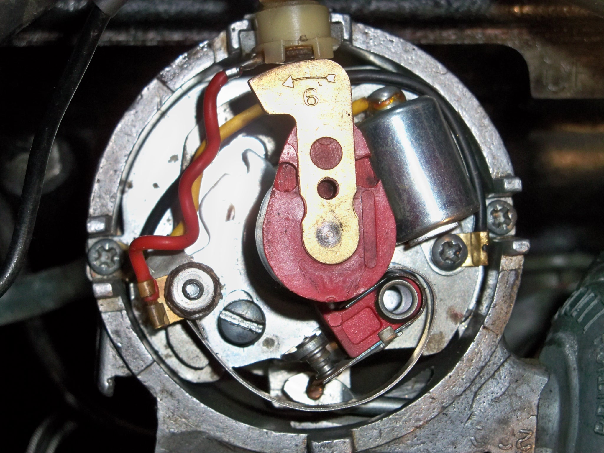

Yes, I've had my DD condenser for a few years.
K
karls59tr
Bronze
While we are looking at the picture....if that "black wire" that is grounded to the plate is frayed and needs replacing how difficult is it to replace? Dosnt look like a regular hold down screw there?:cautious:
poolboy

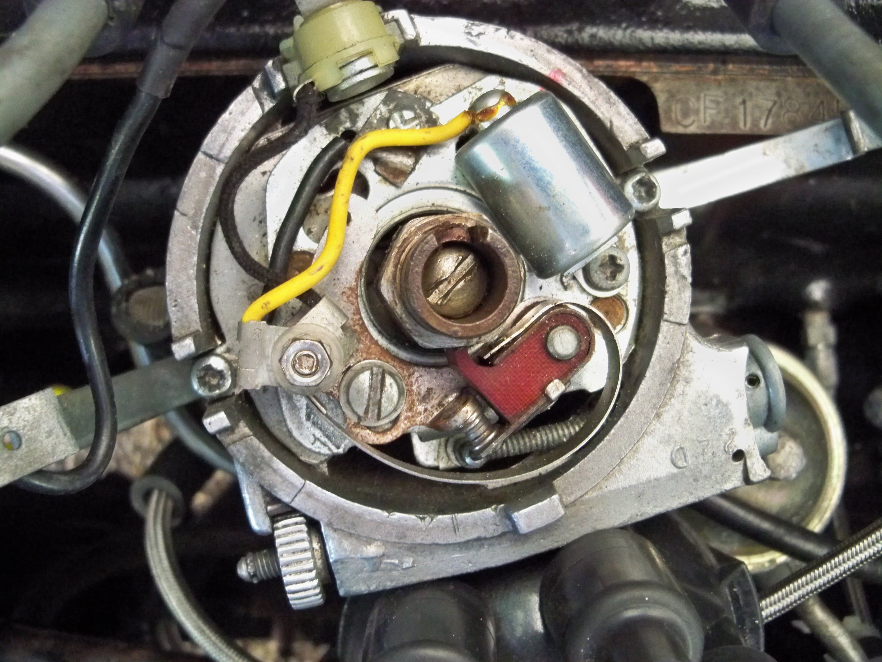

With a properly flexible ground wire such as this you can use the condenser screw for the connection to the points plate

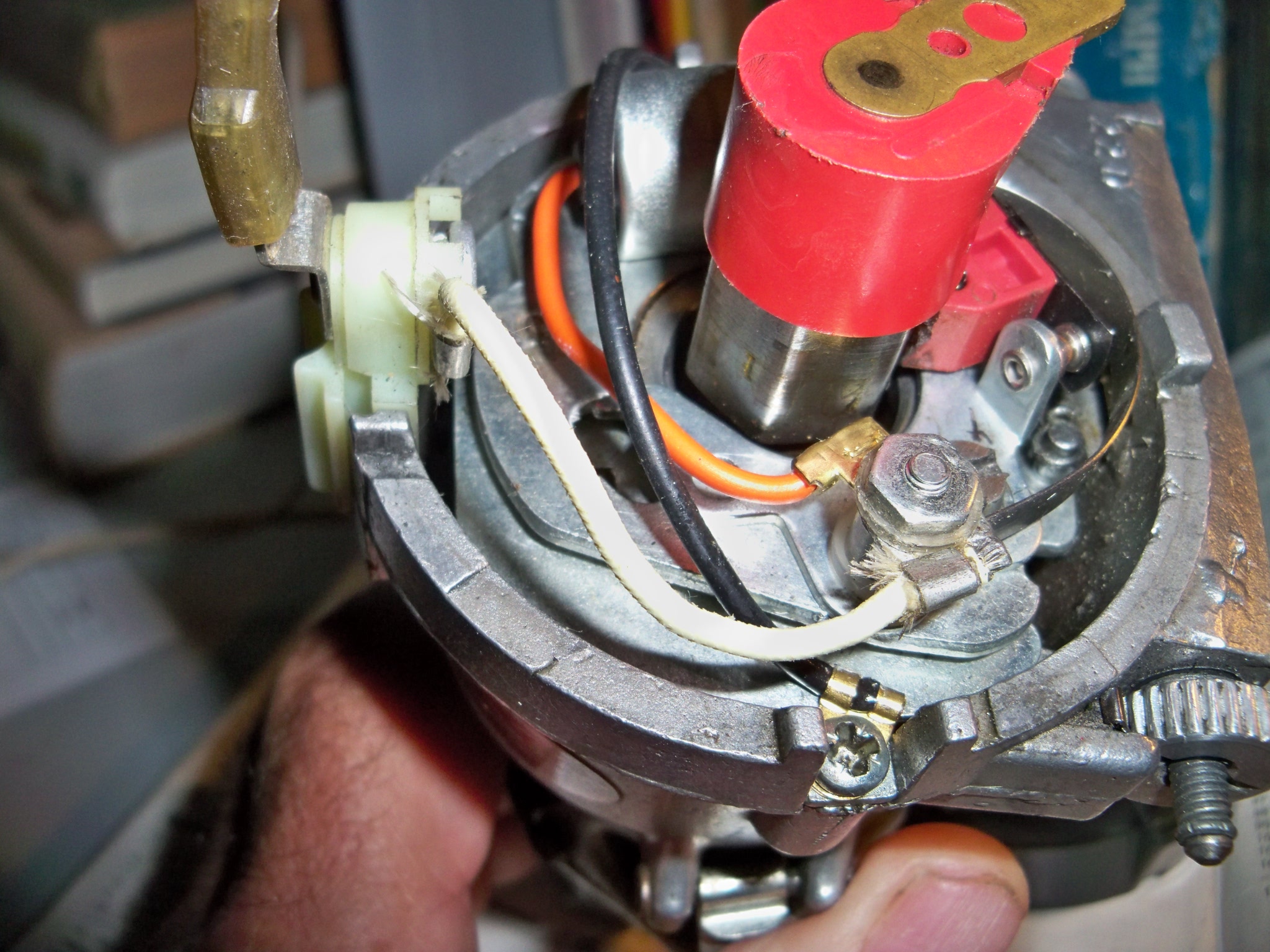

I believe I got the wire from Advanced Distributors...It has to have that flexibility.
