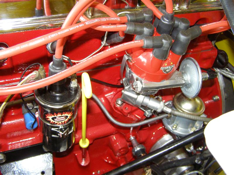

This is a picture of mine. As you can see the striped wire on the right (negative) goes directly to the distributor. The dual wire on the left (positive) comes from the ignition power side through the harness that also leads to the alternator. This is one branch of it. The little blue guy on the block is a noise suppressor for the radio. Not that I ever use that at all.

Paul.... I need one!
Where did you pick-up the noise suppressor? Any info is appreciated. Thanks.
Brosky
It was my original. They are getting hard to find if you want that little blue job.
Gliderman8
Thanks Paul
Guess I need to start looking harder :cry:
Brosky
Actually Elliot, if you just want a functional noise suppressor, rather than the blue dot special, I think that Radio Shack can hook you up. You may even be able to get a similar size and style and paint it to look original.
