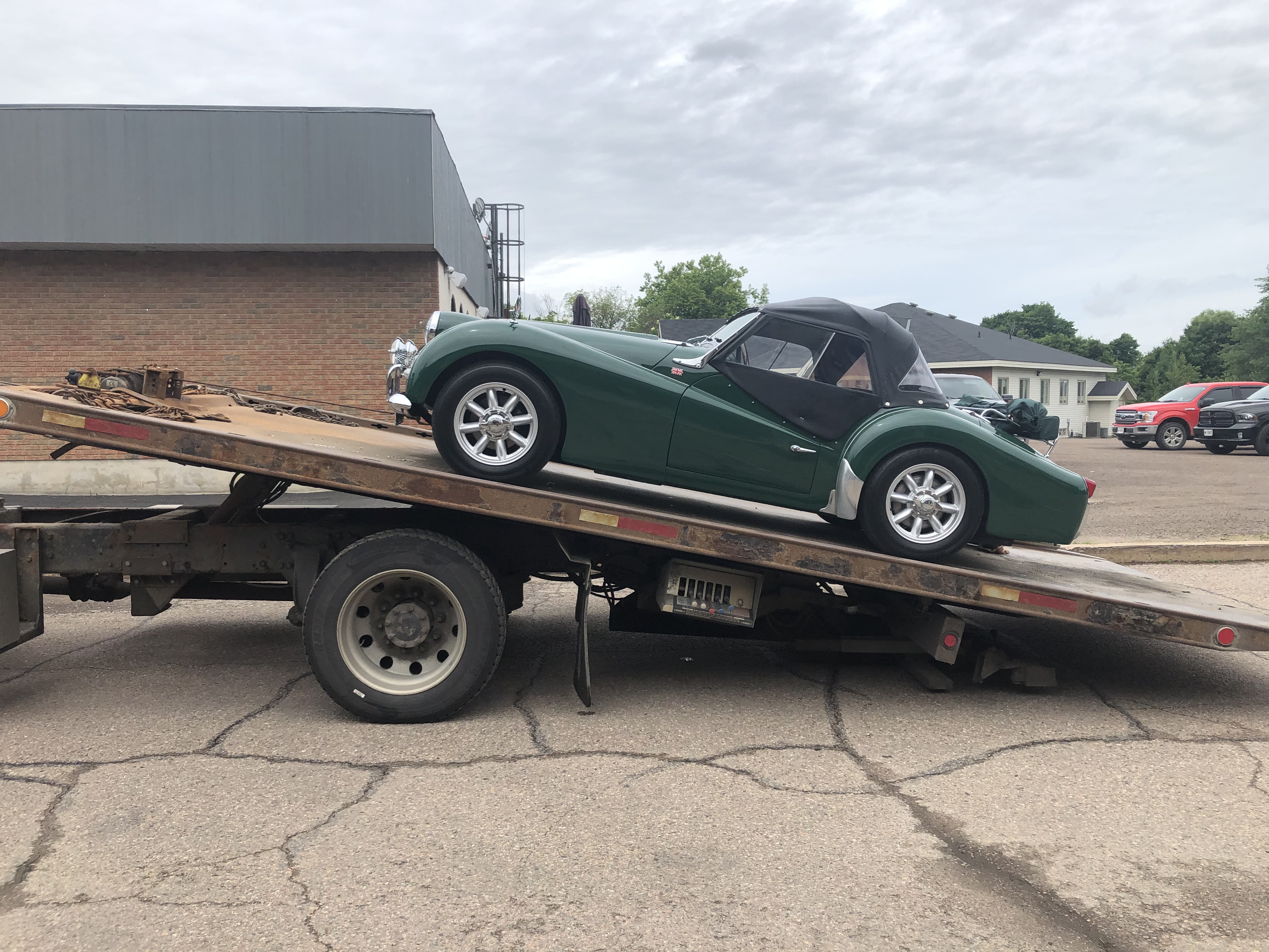

Have driven about 400 miles on the new Slave Cylinder, but had to do subsequent bleeding a few times during that period. Replaced the copper washer in the new flex hose, no indication of leaking at any connections from reservoir and master cylinder. It appears that the new slave cylinder has failed. Subsequent bleeding while on the road gave a “frothy” appearance to the Dot 4 at the bleed nipple. During the bleed process there were brief periods where there was descent feel to the clutch pedal but that was short lived. Pedal goes to the floor now with literally no resistance. Flat bed to home.

Here is an update on my small issue. We probably all remember the expression “you have to prime the pump”. Charley, you were bang on with your assessment and thank you. The master is just a pump and had probably been voided of fluid during some of the work and efforts to bleed. This morning i used my one person bleed device and sucked about 1/3 of a litre of fluid through the clutch system. Bubbles at first of course but after a while clear fluid. Locked up the bleed nipple, wiped up any Dot 4 dribbles and sat in the car. The pressure was back in the clutch pedal as it should have been and the push rod was moving as it should. Important lesson for me is, do it right the first time and save this, below, from happening. Thanks
