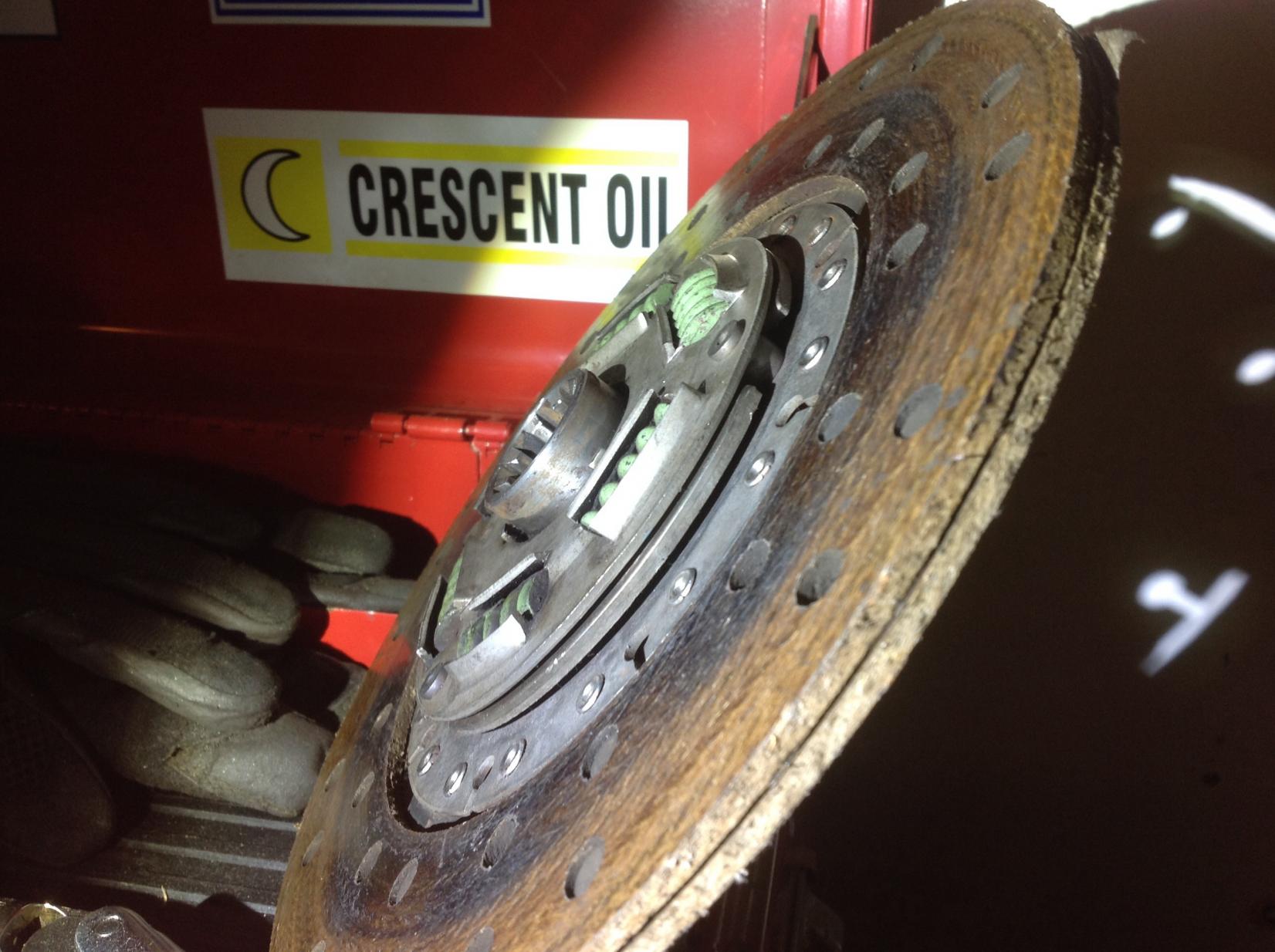

One additional thing to check, based on the pic in post #6 is the flatness of the flywheel and plate. The pattern of the disk indicates that one or both are cupped a bit. This wouldn't generally cause the problem you are noticing but can significantly reduce the life of the assembly and it's holding power.
