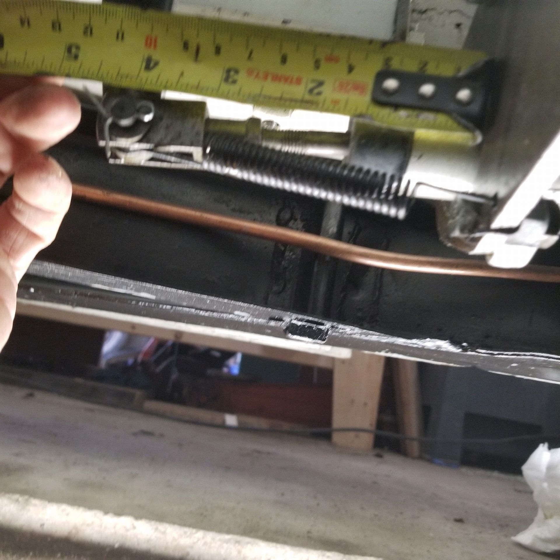

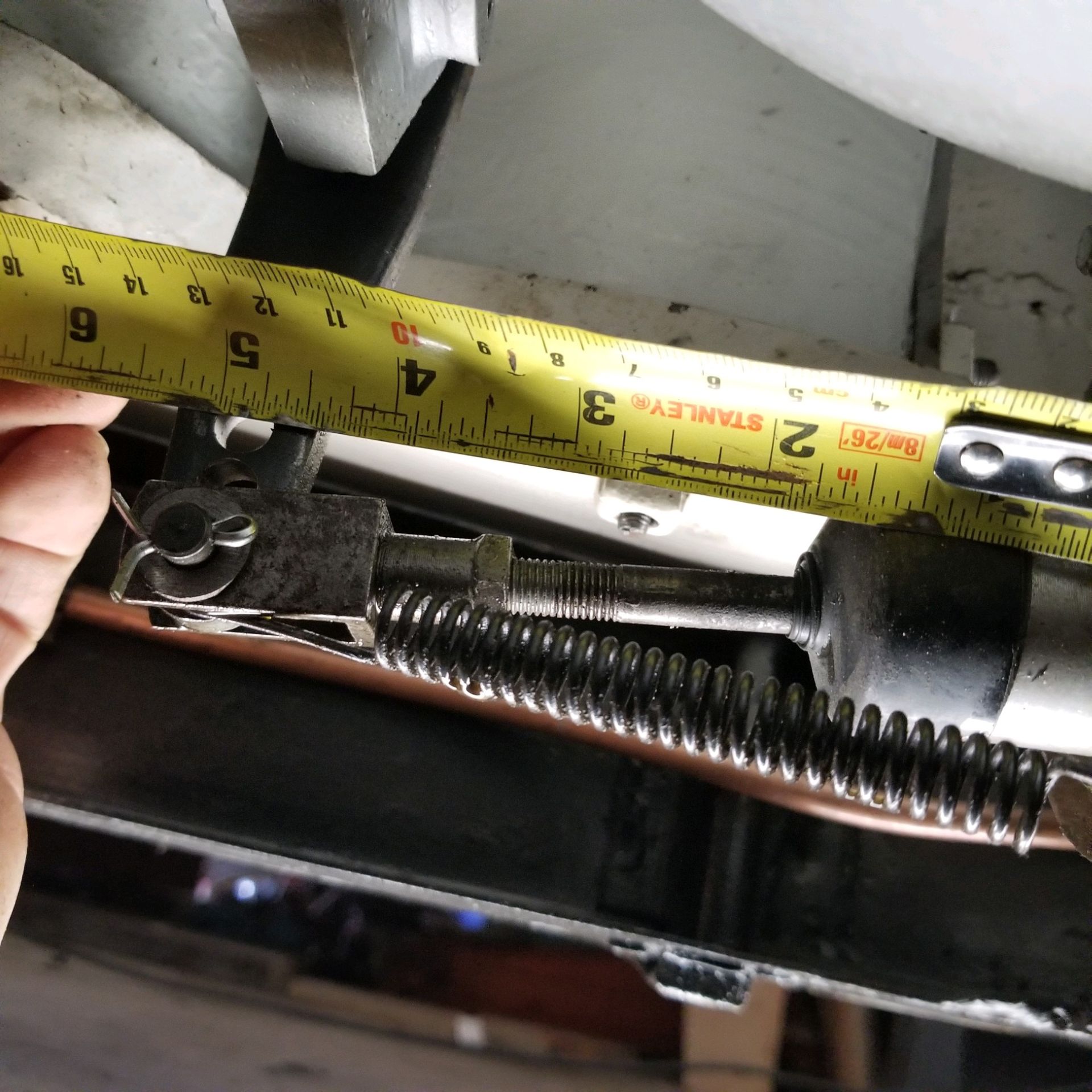

Was the clutch working before the new MC and SC? If it was have you got the SC mounting plate on the correct side of the bell housing? Did the SC come with the same length pushrod?
Since these photos I have moved the clevis to the center hole.
David

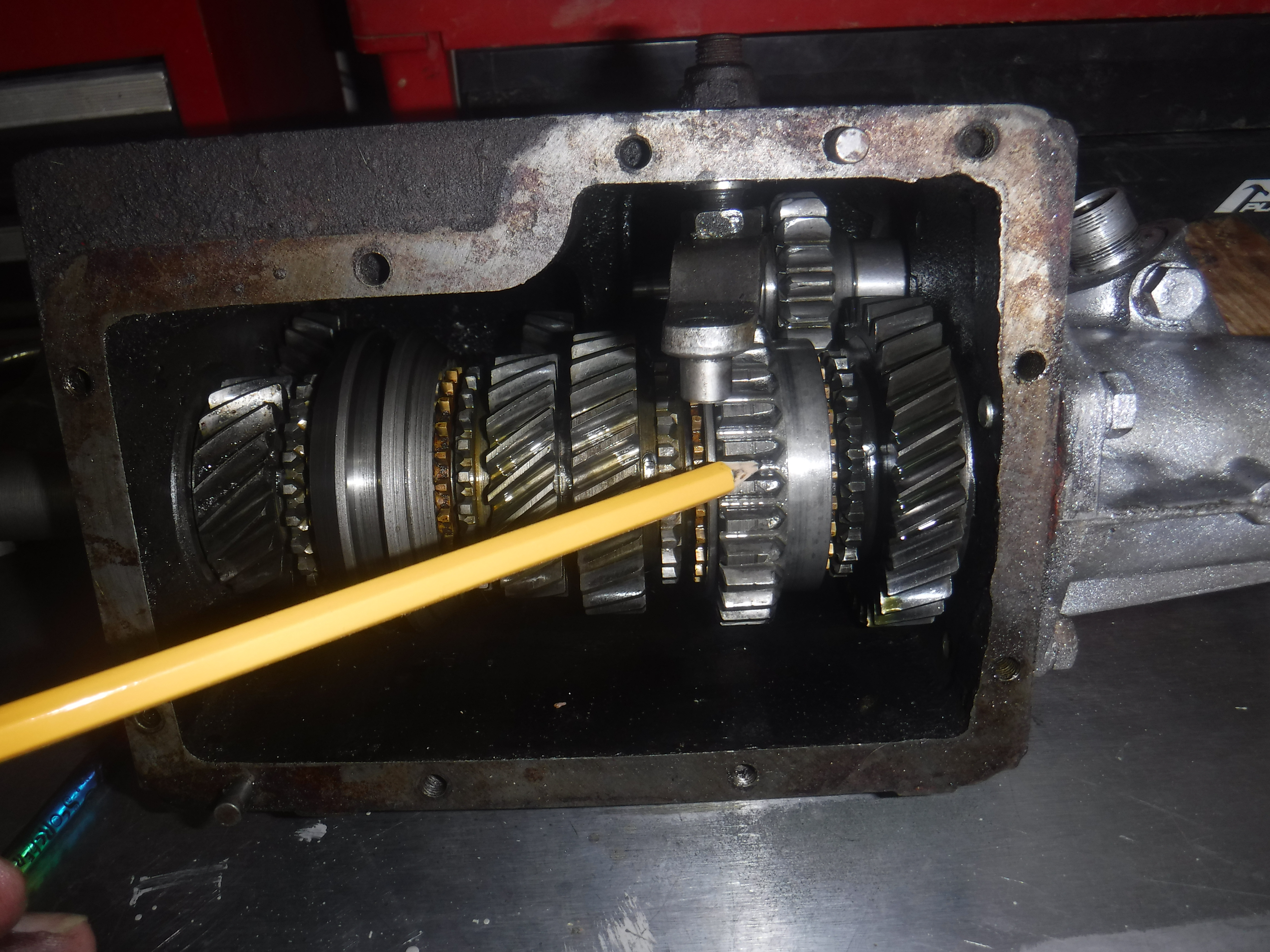

Start this way drain oil in to a screen use a magnet flush case with WD 40 look at gears first rev for any chips or gear aliment check shifting fork for wear should have raised flat pads. Your brass synchro's will look rough that is normal they are a rough casting to start.

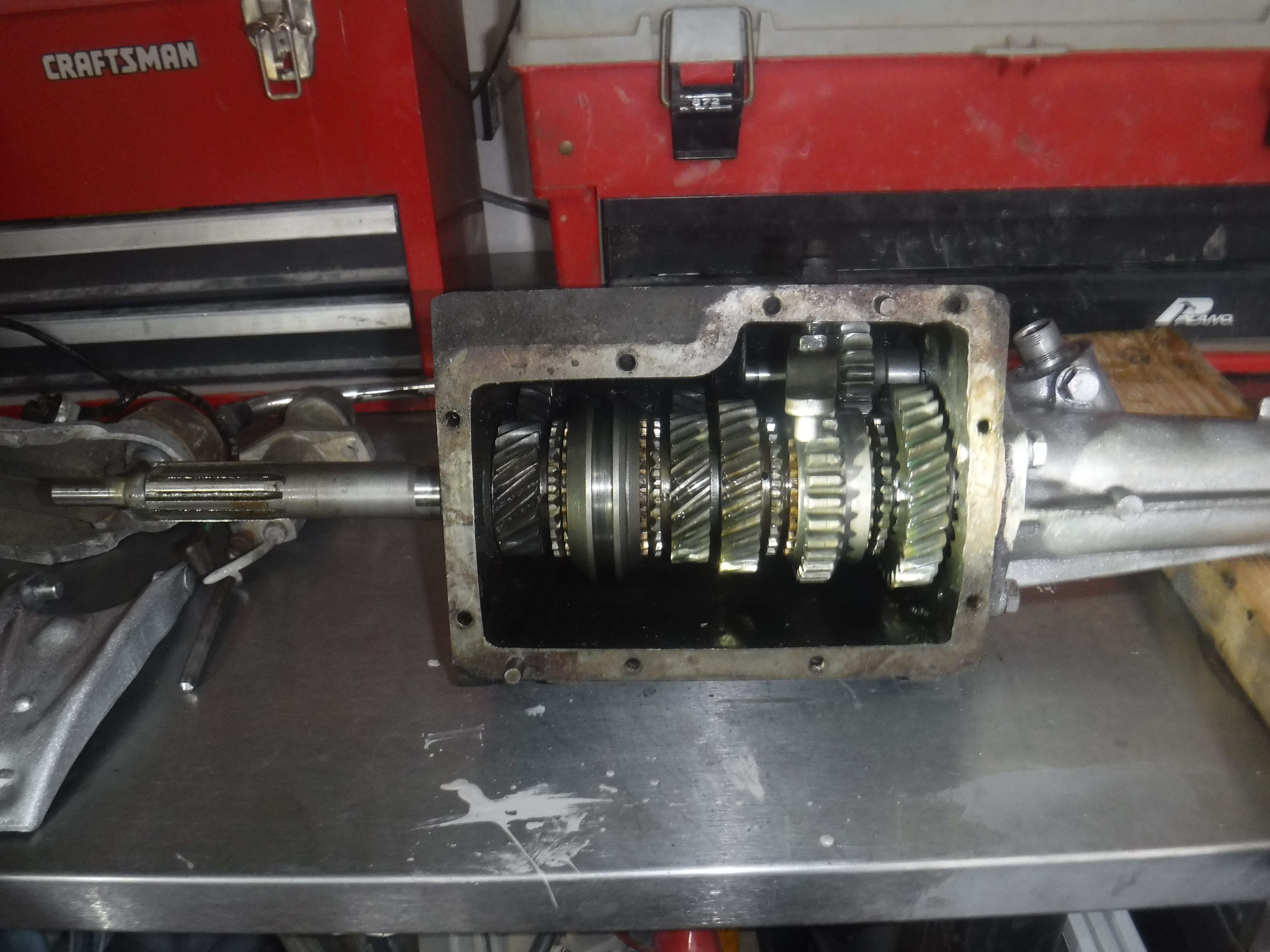

This is a TR GT 6 1972 and most will look the same pic 2 shows' 1st Rev above is rev idler gear these do most work and easy to replace this is also where the two tie together pic 3 shows' wear to fork see little here. wear is caused when driver drives with hand on shift lever. note brass synchro's
