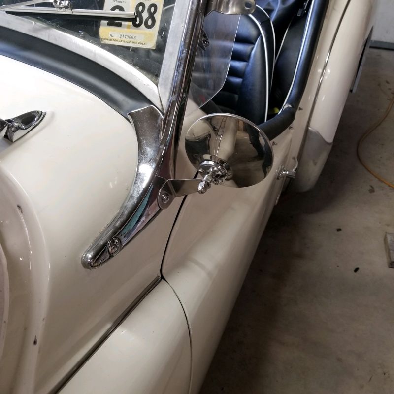

I have a similar one got from a UK supplier. Worked fine but was a problem f I wanted to use the side curtains. So I made a bracket that attaches to the rear station bolt,.
David
DavidView attachment 79530
How do you remove the stanchion bolt if it's rusted in place. Can it be accessed from inside? Did you have to modify the "wind wing" or is the mirror low enough so it is not in the way?
I had no trouble removing the stanchion bolt as it had only been in there for a couple of years since my rebuild. I do not remember if it is a captive nut or a threaded plate. You may be able to spray some PB Blaster up through the hole you access the top wing bolt.
The mirror is far enough out that it does not interfere with the wind wing. It is nice because I can adjust the mirror as I drive. Looking at the photo it may be my version 1. Version 2 is a bit longer and angles up a bit more.
David
