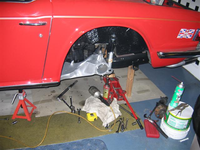

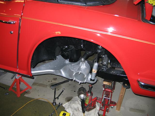

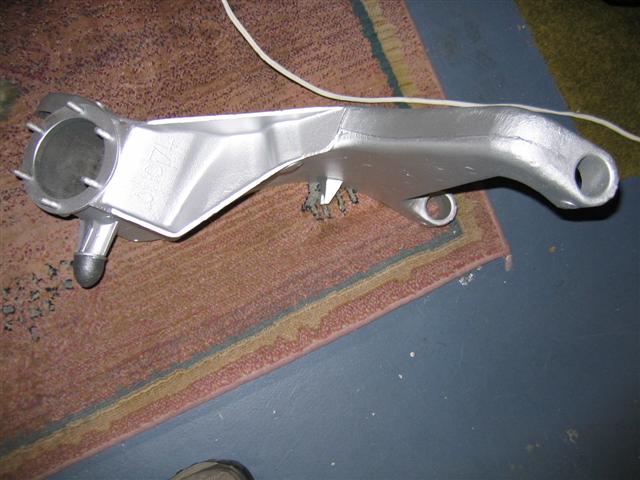

Did about the same as you Ray, scrubbed,wire wheeled them still didn't look all that great. Blasted them, still not happy. Painted them with VHT silver caliper paint. :yesnod:happy now

Nice looking trailings arms. Nice looking project.
You either did this correctly after the photo
or you messed it up.
The 6 nuts that go onto those 6 studs get tightened
to 14 to 16 pounds. Any more and the steel studs will
strip out of the aluminum threads of the T/A.
I tightened mine to 14# but the temptation to add more
force was certainly present.
