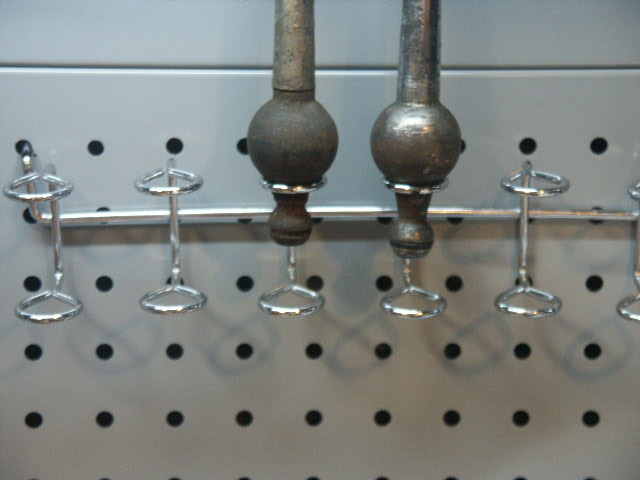

This is a side by side comparison of the shifters. To make the pivot equal I sat them in one of those peg board screw driver holders. This is what it looks like. The ribcase ones are about 1/4" longer than the smooth case.

drooartz said:
I remember reading somewhere that if you wanted to use the smooth case shifter, you needed to swap over the entire remote change assembly. Can't remember where I read that, though.
hmm interesting Drew, never heard that one before. Thanks for the info.
Pat
Thanks, Chris. I guess that answers the question. Should the remote change assembly be swapable between the 2 types?
Is the later ribcase different than an earlier one?
Shoot I knew that but did not remember. Sigh, old brain.
As I recall-- The remotes ARE interchangable but just that the later type is "short throw" while the older ones made you bang your knuckles into the dash.
