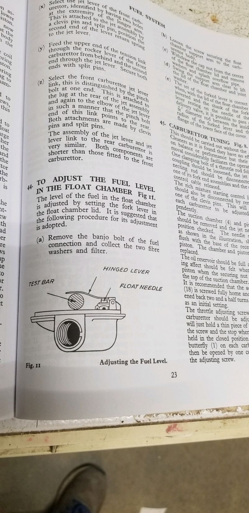

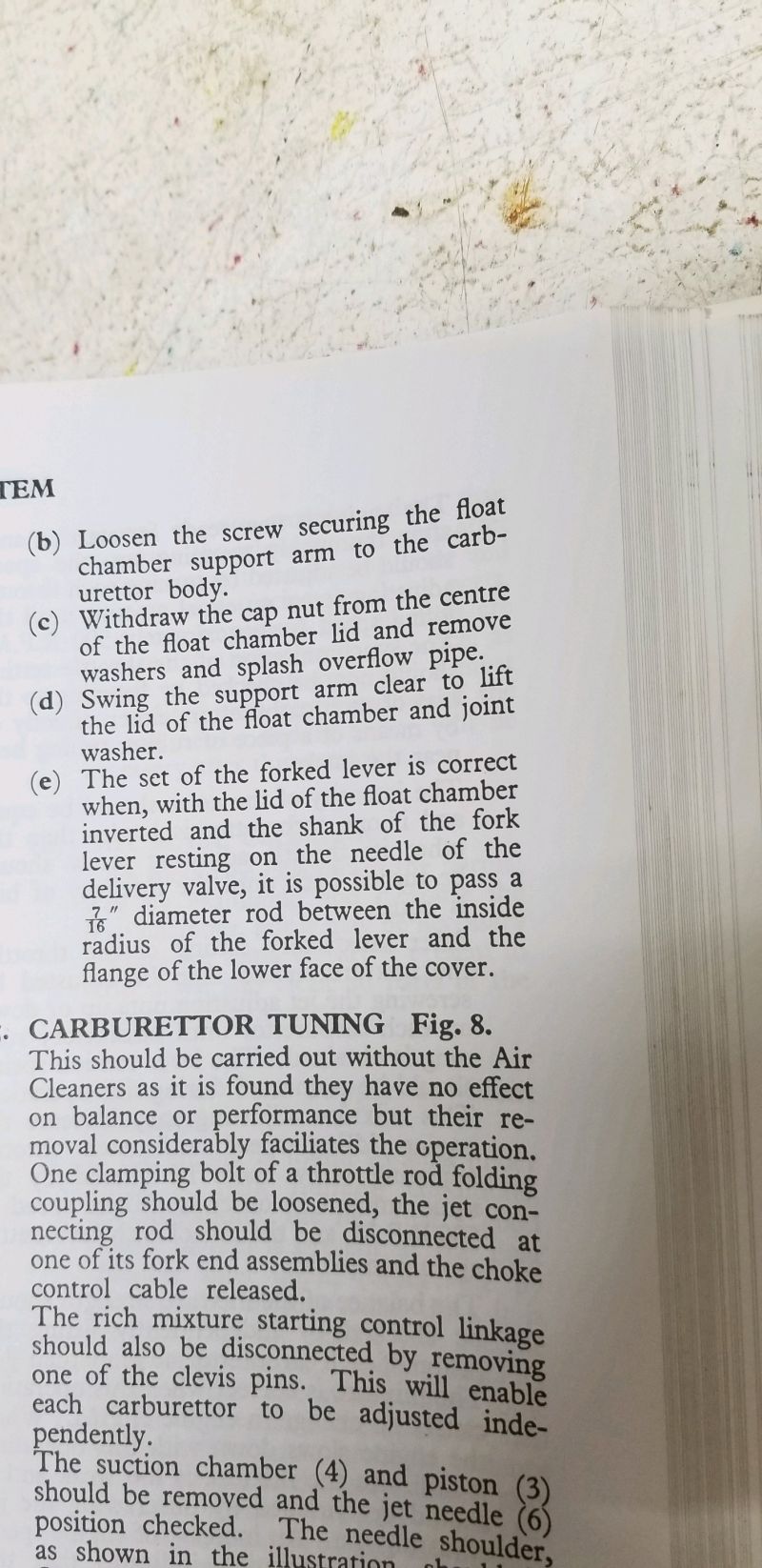

. Immediately look down the carbs to where the needle goes down into the jets. You should see fuel there, but it should not be high enough in the jet to overflow down the carb and intake. If you cannot see the fuel level, raise the piston to raise the needle to get a better view.
I'm back to hard starting after it sits. Looking down the jets, here's what I see. Carb 1, the front one, has fuel right to the top and likely spilling a little bit down the throat of the manifold. Fuel in Carb 2 is lower. I see fuel over 1/8 inch down the jet. A bit too far. Is any of this material enough to cause my starting issue? Based on weather changes and the behavior of the car, I'm disinclined to suspect a vapor lock. My pump looks fine and my fuel line is insulated all the way, plus I have a heat shield.
DavidApp
Sounds like the float on No. 1 carb is sticking or the arm is not set to shut the fuel off at the correct level. The rear one may be too low.
Have you checked the float level?
David

I finally pulled the float lids and checked the needles and floats. Both needles are viton tipped. Not sure I like those, but they're there. Gas level was about 1/3 of the bowl on each carb. One float was, itself, defective and half full of gas. So, I put in new floats and adjusted to HS6 clearance, and cleaned and reinstalled the needles. I'll report if that fixes my issue.
