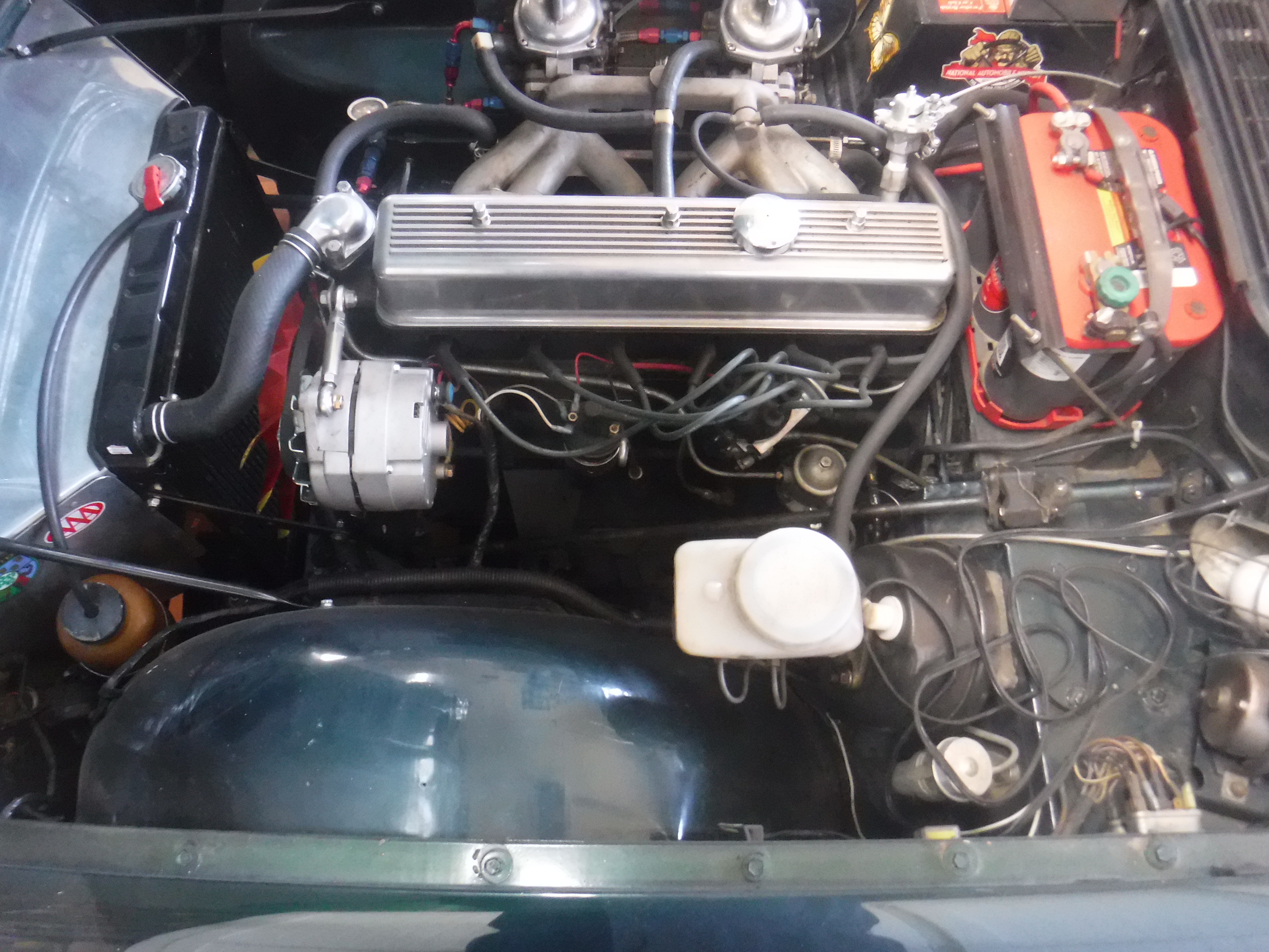

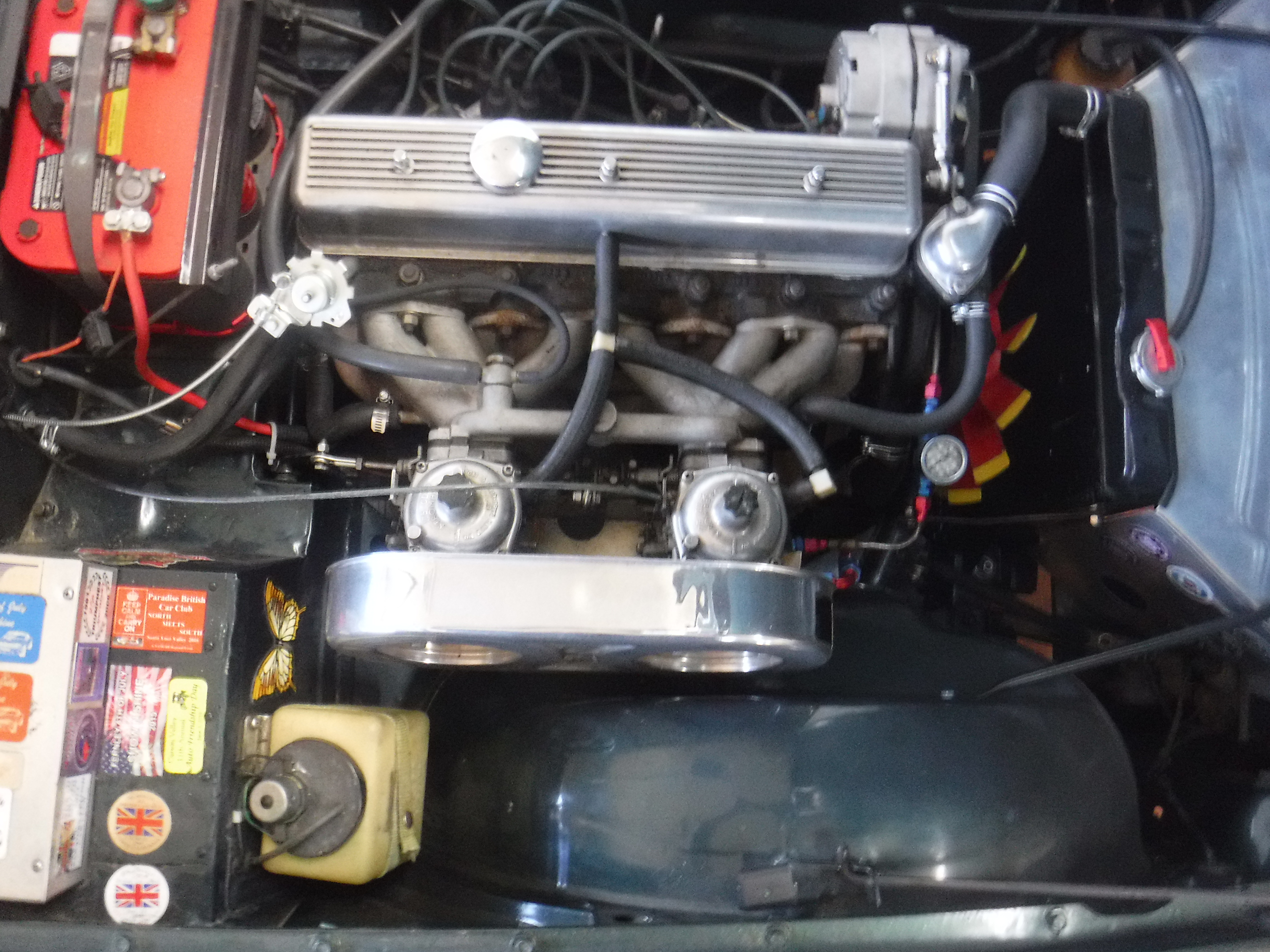

normal filter location most all TR's this is a GT6 pic one note fuel line around head.pic two and three is TR6 in pic three if you expand pic check fuel line around head. I added a screen door spring over my fuel line to act as cooling fins. I think your cover is doing the opposite of what you want.
NOTE here is a tip I learned this year. With motor idle and at temp thermostat open feel your carb tops they should be not cold but cool and twin carbs should feel the same temp. Why?? our carbs work as a Venturia to pull fuel and then mix with air raw fuel does not go into cyl but air fuel mix is atomized or vapor. So your fuel is say cold and ready to burn but if to cold as in to rich poor burn rate less power fuel out the tail pipe. As in raw gas smell. That is the reason for the water tube through the intake manifold to raise fuel mix to a better burn rate. There is a system for every thing in our cars. Knowing how things work in a system and seeing and understanding the same makes for quick work when some part is not right.
