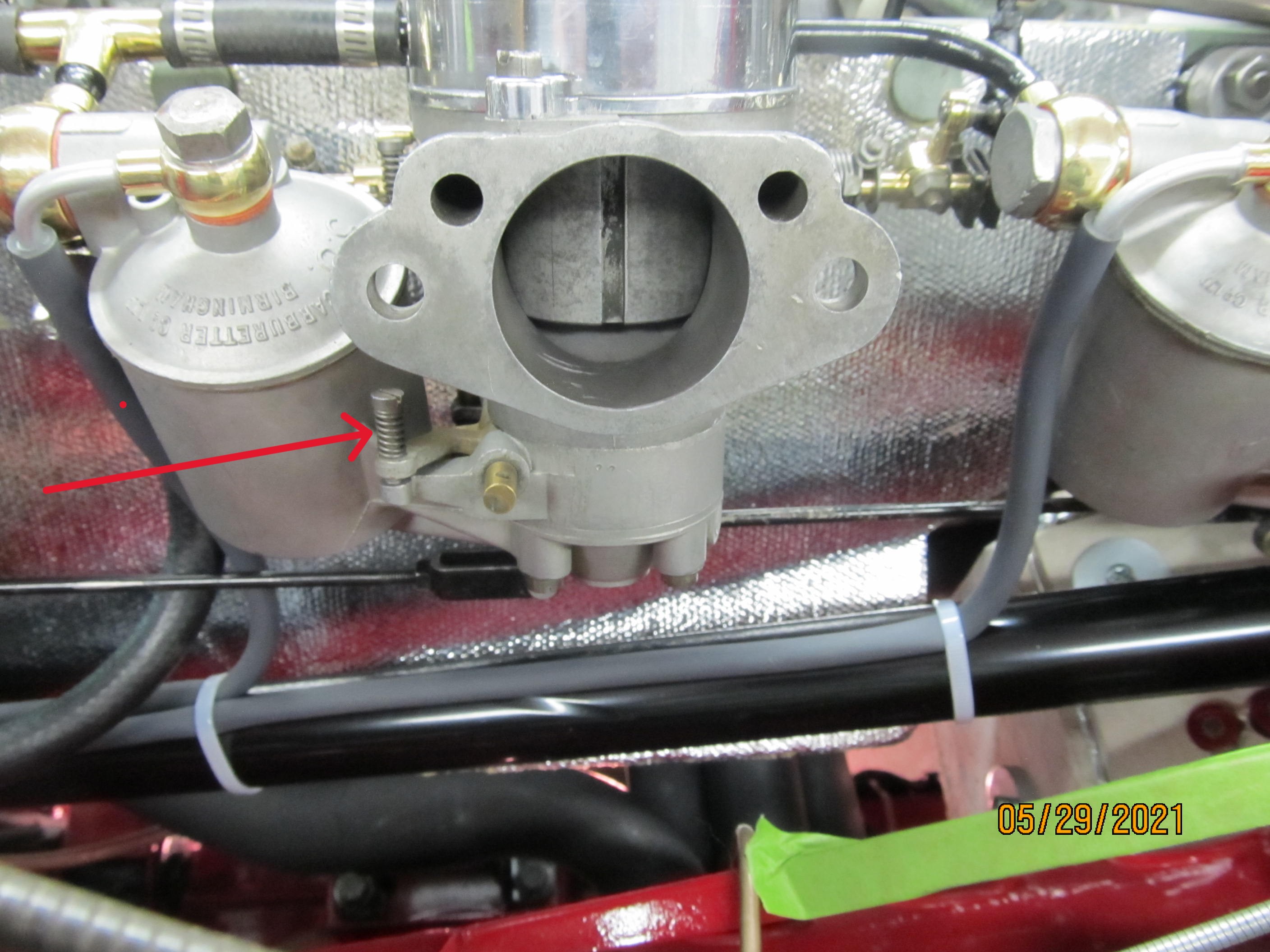

You adjust rich/lean by the jet adjusting screws (see picture) to raise or lower the jets as spelled out in the manual (if you don't have a manual, you really need to get one). After you have achieved the best mixture, you need to remove the dashpots and pistons and measure the distance each jet is down from the bridge - they need to be the same.

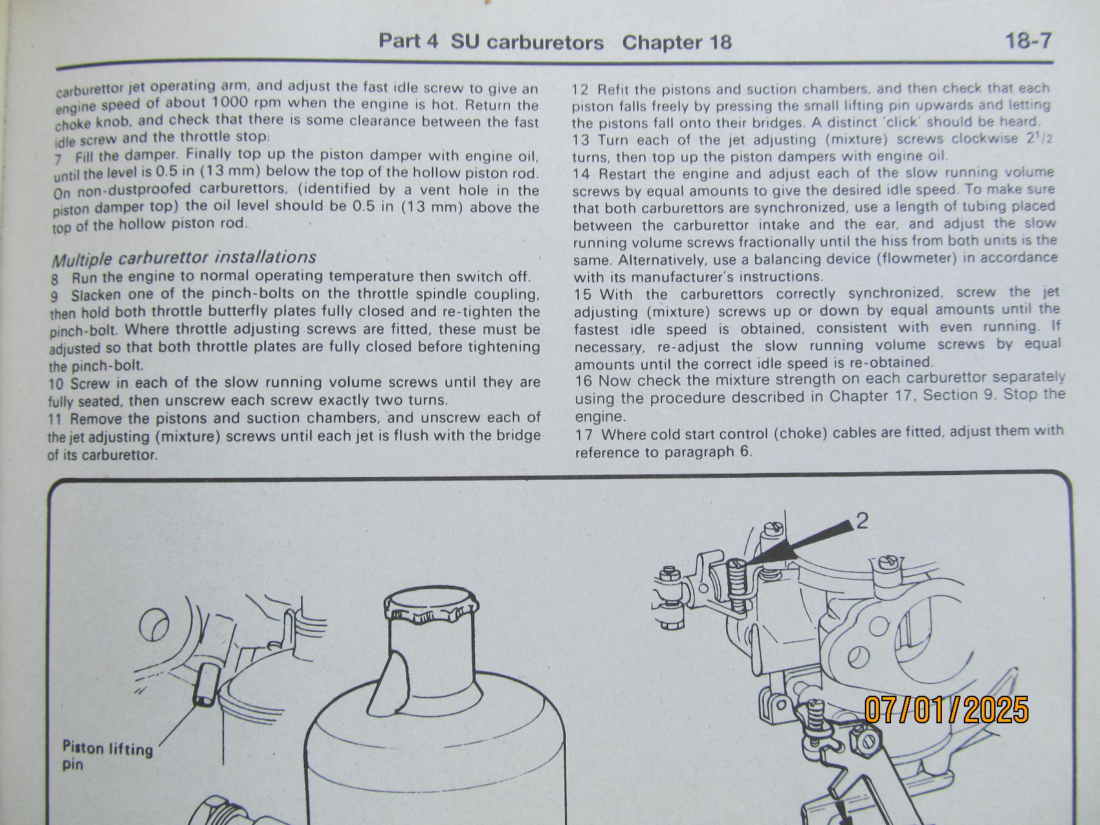

If you are near sea-level you will most likely need the CV needles, so before you start changing needles I suggest you should try to follow the steps in the manual - see attached photo of a page for HD carbs. All SUs work the same way - just the methods of adjusting the jets and setting the idle are different in the H & HS vs HD.
You say your jets are down about .078", try bringing them up to around .060" as a starting point. But if you follow the steps in the manual you should be able to get a good mixture. It is good that both jets are at the same height.
