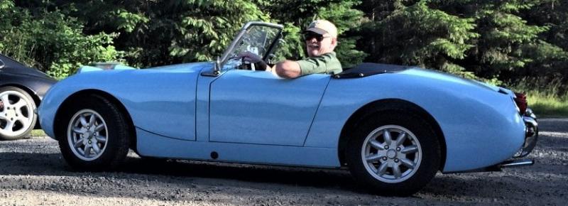

I have 175/70 R13s on mine. Biggish, but they work with the admittedly wider Mini-lite wheels I have. No issues.
I should add that before I replaced my front springs and shocks, there were some issues when I hit a turn hard (but no more).

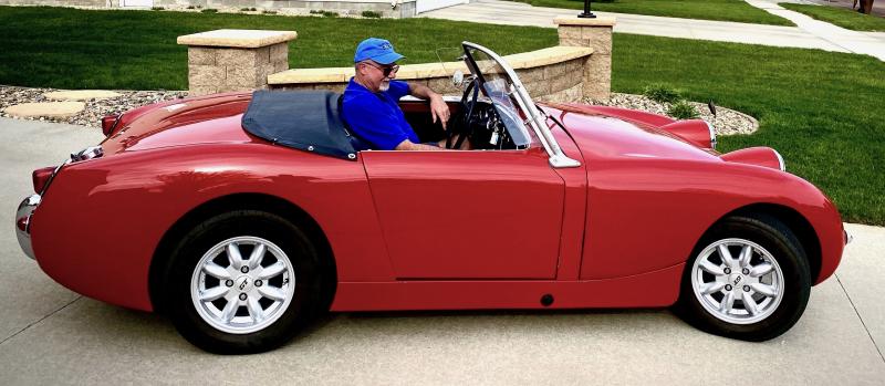

Thanks Boink/Mark, I will follow-up on the offer of free used 175x13s. I'll measure the width to make sure my original style wheels are wide enough. Yoda looks great. Sid
