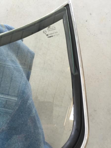

I installed a new windshield in the frame this morning. I had read many threads warning of the difficulty of this procedure. While I typically seem to run into as many or more difficulties than others when I do a project, I found this to be relatively painless.
I used the windshield and gasket from Moss, and both items were high quality and perfect fit. Kudos.

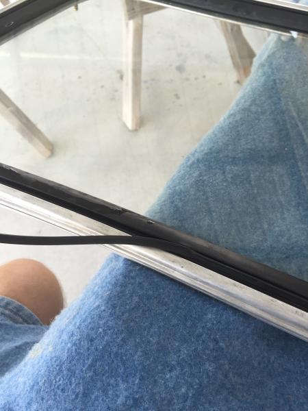

I used MacGregor's frame to body seal based on what I've read on this site. Slid into the slot on the bottom of the frame with little difficulty.

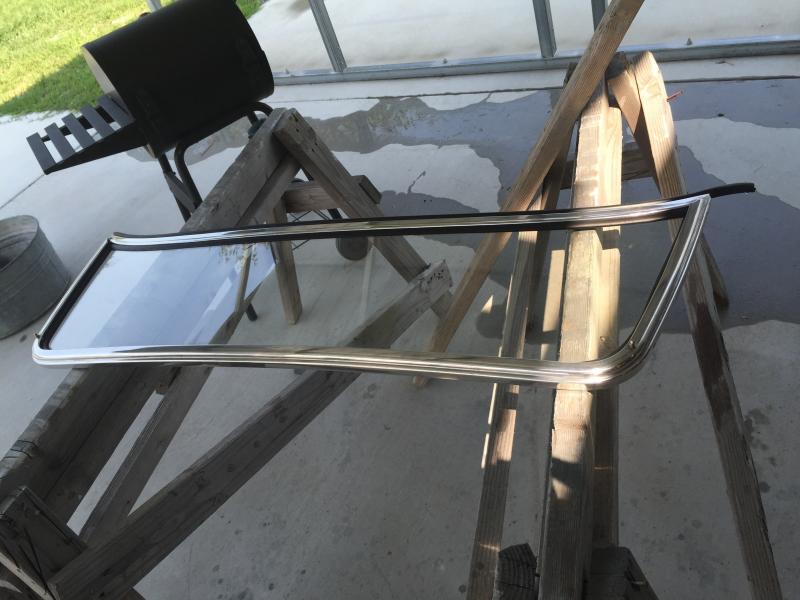

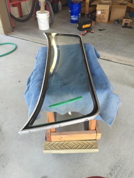

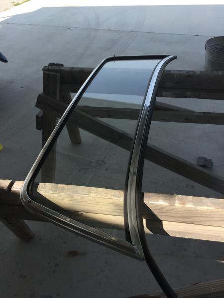

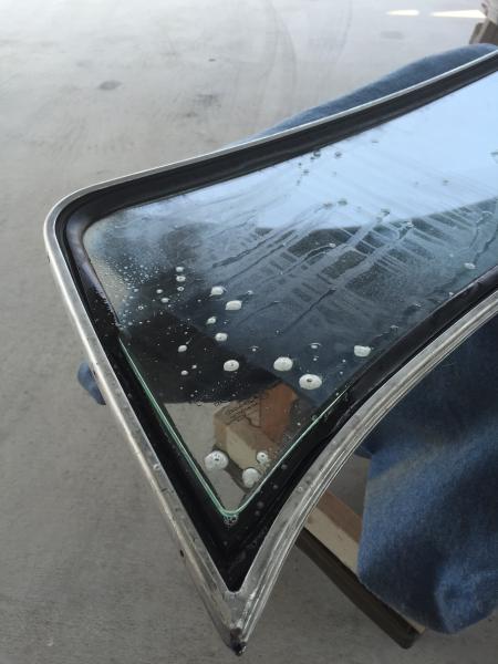

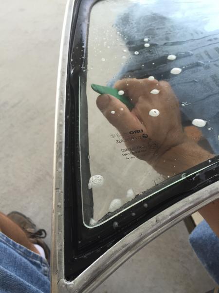

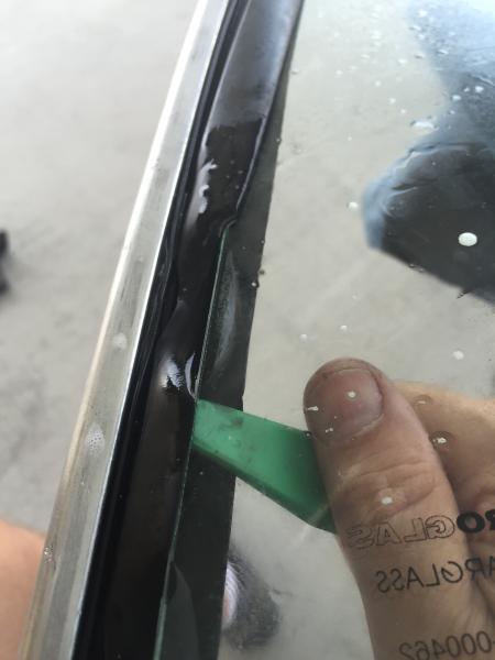

To install the windshield, I placed the gasket in the frame and lubed it generously with soap solution. I placed the windshield over the frame/gasket and put the glass into the gasket along the top, bottom and upper sides with a little stretching of the frame to get the top and bottom in. Then I used the windshield stick tool (I think I got it at VB) to work the glass into the gasket from the sides down and the lower frame out, working towards the lower corners. It worked best to push the inner lip of the seal past the frame with the stick on the outside pushing in.

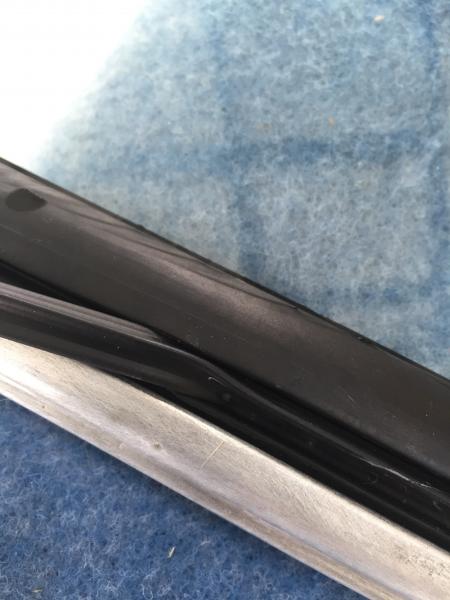

There is a slot in the gasket, with a filler strip that is installed after the glass is in. The slot side of the gasket goes to the interior, and allows the inner lip to bend more, giving you the clearance needed to get it past the glass. The filler slip is pushed into the slot afterwards.
Overall, fairly easy, with not surprises or particularly troublesome issues. It takes a little patience and go slow, but as BE projects go it is not one of the more difficult.
Here are some pics of the process:
