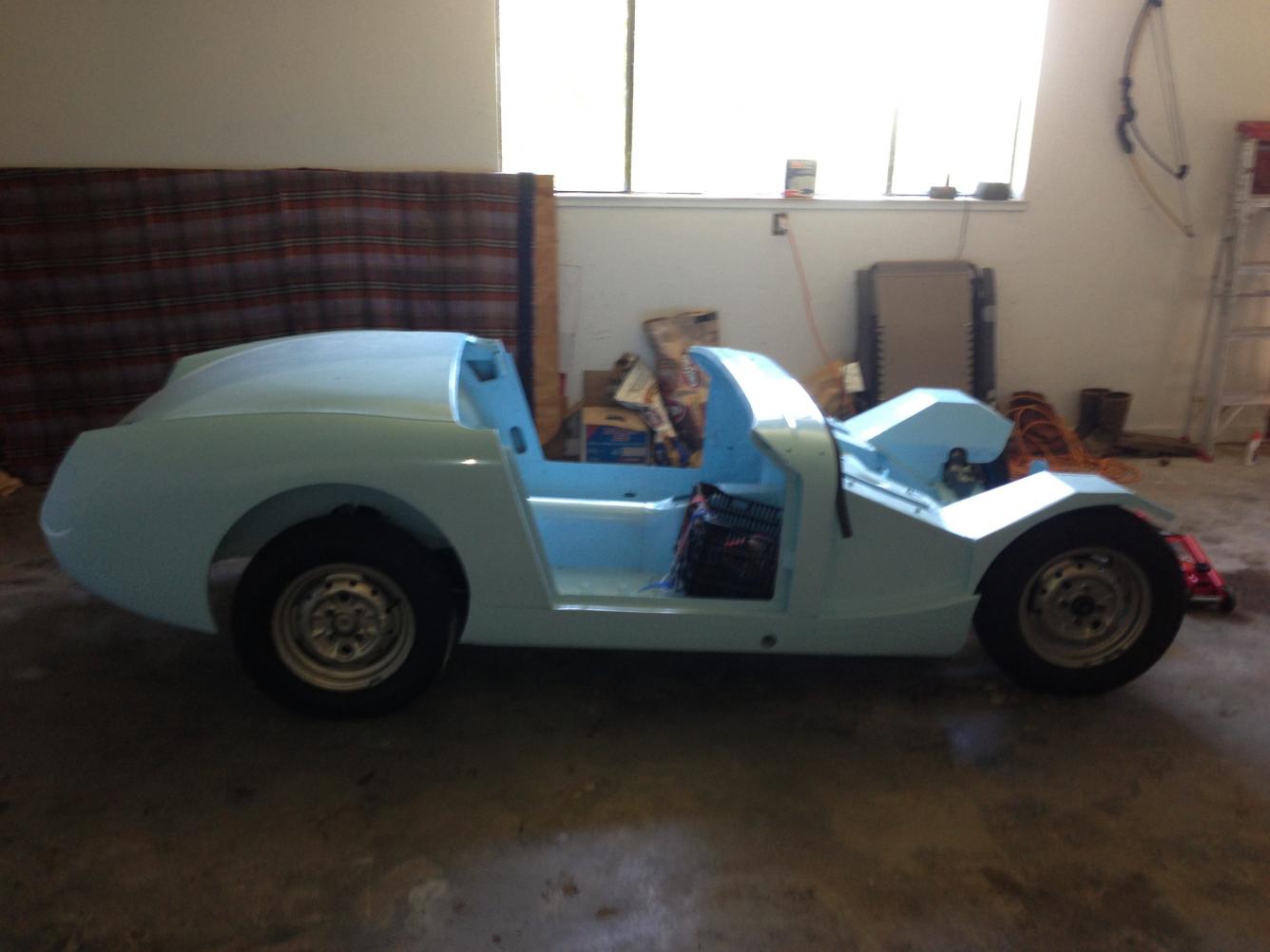

It was Interlux Brightside light blue! It was sprayed but you know how it can be applied alternatively (just follow the intructions to the letter if you go to bare metal). The parts are nearly all ready and my uncle will be here March 27th to help install the engine and transmission. I have to make it a roller by then.

Well she is on 4 wheels ( minus springs) Progress will now be more rapid as the car now can come home to my garage!

It was Interlux Brightside light blue! It was sprayed but you know how it can be applied alternatively (just follow the instructions to the letter if you go to bare metal). The parts are nearly all ready and my uncle will be here March 27th to help install the engine and transmission. I have to make it a roller by then.

Paul, I bought white brightside with the intention of rolling, but today I chickened out and bought an HVLP gun. Any tips on spraying Brightside? I've been going through the interlux forums, for hot weather interlux recommends thinning with about 10% of a 50/50 mix of brushing thinner and spraying thinner to slow down drying.
yours looks awesome btw.
Thanks,
David
David
Hints wait till cooler weather. :smile: i would do a test vertical piece or a door to check compatabilty at the temps and humidity you will be spraying at. I rolled my hardtop and it came out great, however lots of wet sanding b/t coats. I sprayed during on a warm (70 degree) winter day. You will find it lays down very nice. It had no orange peel. Leave it alone to harden for 30 days, before polishing or wet sanding.
